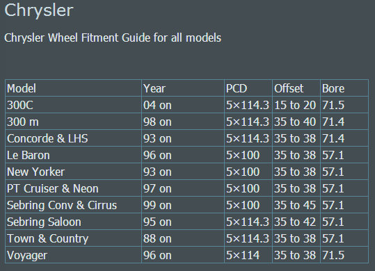

Thanks for that. The PCD isn't the problem, it's the ET value that I'm concerned about. Grand voyagers have a tolerance of between 35 to 45 that I'm aware of. I think the 300c comes in at about 25. So if I need to fit spacers then so be it, but i would rather not. Wanted to go down the Chrysler OEM route, but it's looking like I might have to go for after markets instead. As I said before, there is a pic on here somewhere of a short wheelbase voyager with 300c wheels on and it looks superb, just need to find out if it had spacers or not, or do the early pre 2000 voyagers have a different set up.

Your quest continues to be a guess that needs treble checking with an individual 02 owner who can confirm he has successfully fitted 300's to his vehicle - or getting a 300m alloy and a set of mixed spacers and doing a trial run - I for one would never give advice. The above chart suggests that the 300's be they C or m are bore & PCD common but their ET's are 20mm [ish] different. Further the 300's and the Euro-Voyager are a similar 20mm [ish] different and the earlier American T&C are also 20mm [ish] different. Whichever you choose you appear to be 0.3 PCD out on your studs and / or / 20mm out on the offset.

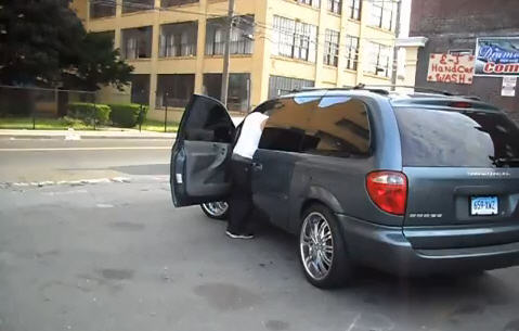

Personally I think the 300C wheels look great on that green 90's Voyager. I've always thought that the Voyager needs bigger wheels to fill the arches. The 22" on this Dodge look fantastic.
