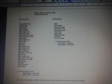

Hi, I've finally managed to fit my Towbar after removing 4 badly rusted in M12 bolts. So to wiring and a record, for anyone else to ponder over, here's a list of the wires that come down the middle of the floor then split off at rear door to nearside(left) and offside(right) lights etc. I've still to find what they supply but if anyone has instant answer please add and I'll add to this list. Note some wires like Purple/Lilac hard to tell right colour.
Thanks.
Ahh, not uploading, will follow up.
Had to take picture of my Text & send. Not so good.
Attached Thumbnails Wiring inside Rear Door for Towbar or Info.-chrysler-wiring..jpg
Last edited by goggs; Jun 23, 2014 at 05:38 AM. Reason: Wouldn't upload my Text. Had to take Picture & send.

I'll try QinteQ suggestion, dam'd I'll get it eventually, as it'll be interesting to see where all those wires go. 31 wires to nearside. 14 wires to offside.

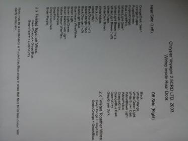

Tried QinteQ suggestion but ended up with 1/4 picture after scan and 377KB, I'm not quite into this thing. Anyway got picture printed and took picture with my Pad. Looks not too bad.
Attached Thumbnails Wiring inside Rear Door for Towbar or Info.-chrysler-wiring-pic..jpg
Old Jun 24, 2014 | 06:38 AM
Paint - you did the select and crop correctly, you overdid the resize [trial and error - what looks right is about right] and made it too small, it should have been 50% bigger on both axis and you forgot to rotate before saving and sending to imgur. All in all it is ok and readable.
