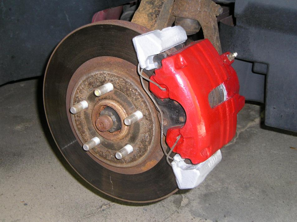

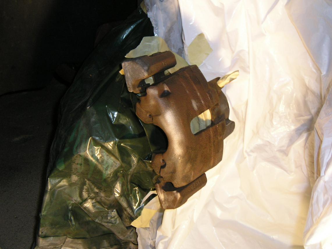

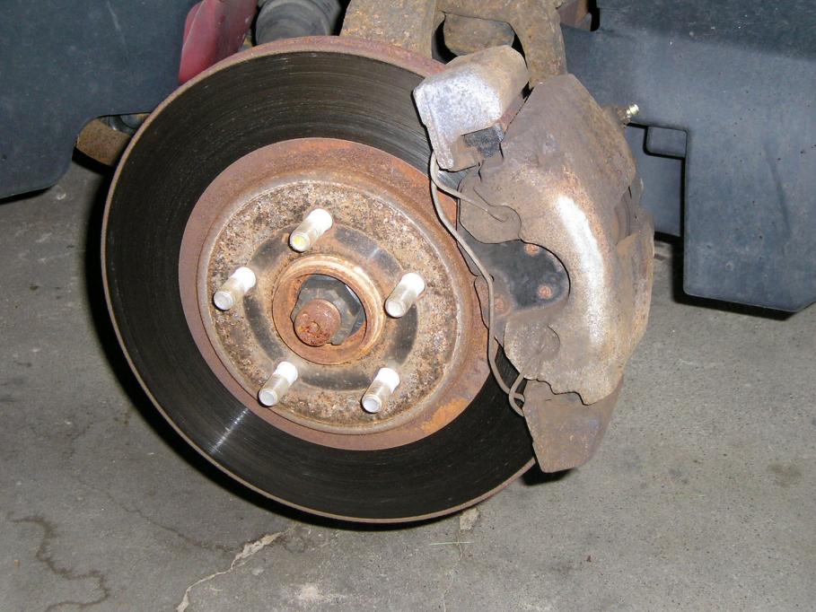

The three pictures show the right front caliper in process. The first one shows the "before" condition. The middle one show the caliper wire brushed and sandblasted, ready to paint. The third is "after". Worth all the work? Not sure. I'll see if anybody notices.
