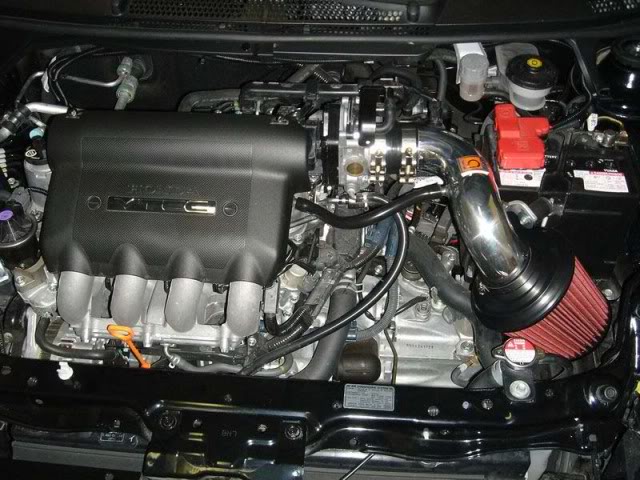

Or similar to this?

Personally, I can't understand why people think that they are getting a "Cold Air Intake" by doing this. On my Sebring, the factory "box" actually draws air from the fenderwell area, that is, from outside the engine compartment. These K&N cans draw air from right behind the radiator. That's not what I would consider "cold air". They might be a little less restrictive, but only at the cost of allowing more dust to get in, since they are not as big as the stock air filter.
If there's some advantage here, I'm not seeing it.

I totally agree unless you have some sort of snorkle unit into a hood scoop,Front Fender Opening (As NASCAR has) you are actually drawing in much hotter air then a stock intake box, If you want to check for yourself drive your vehicle until up to operating temp and then drive back home or to wherever you work on it and immediately open hood and stck you head in close to where the opening for the aftermarket intake would be and see how long you can remain in that area and notice how much hotter it is then outside of engine compartment.
