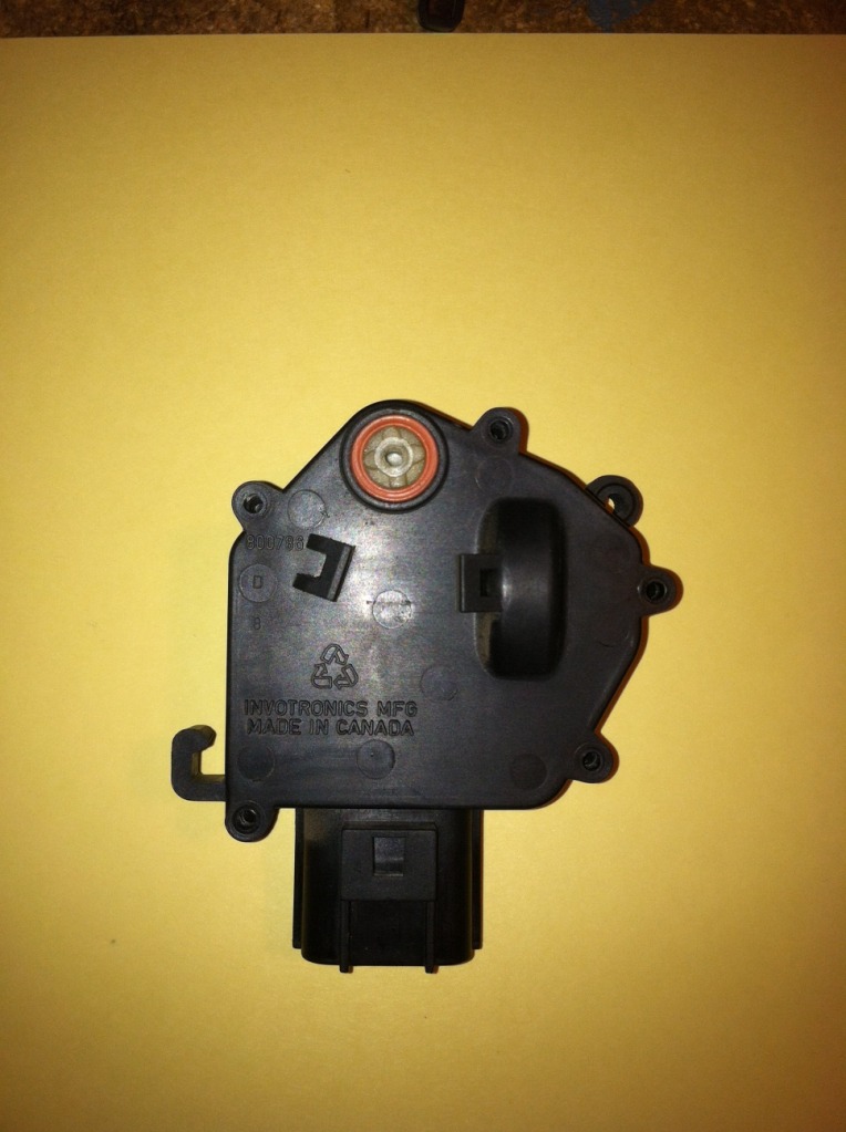

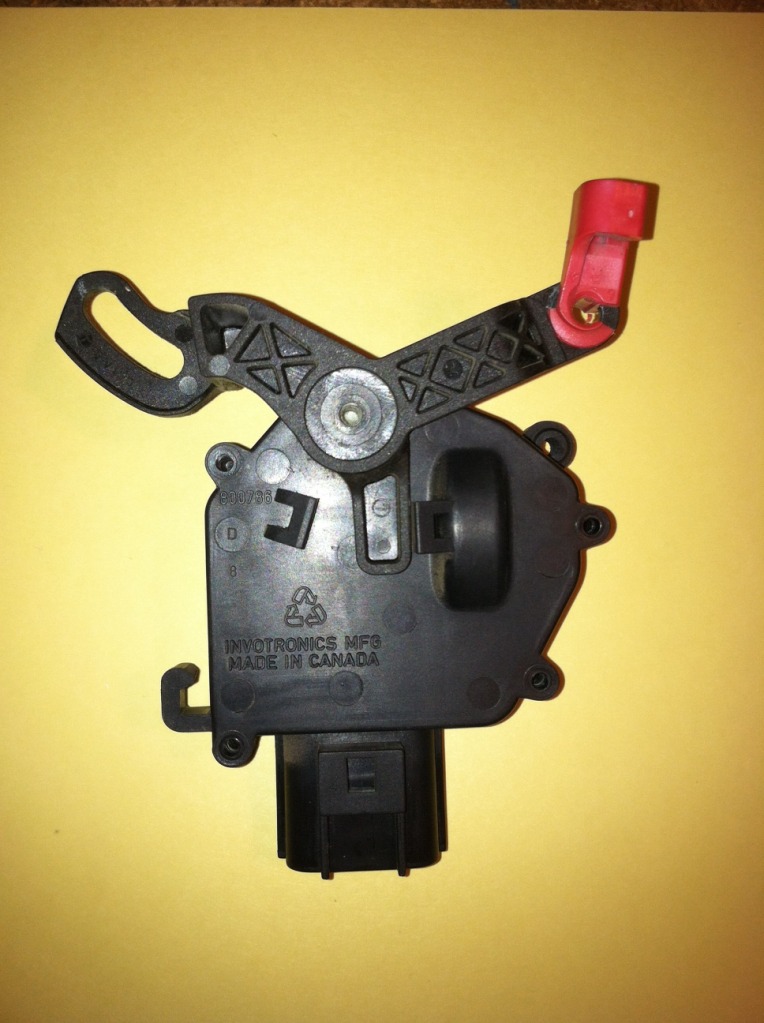

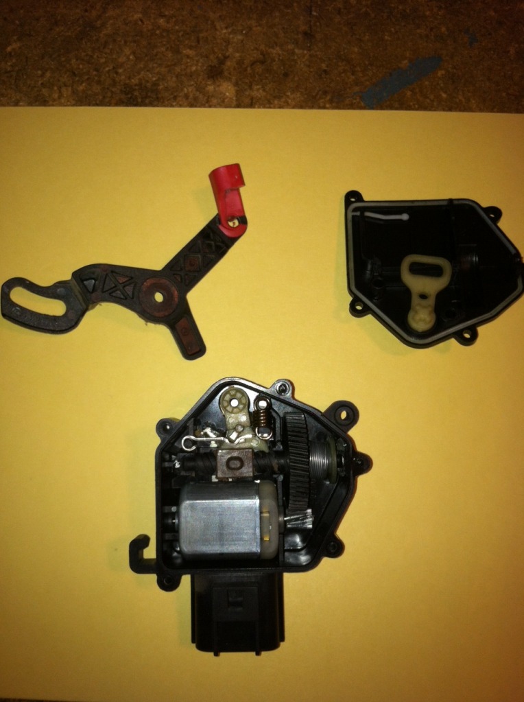

Another update: Since not just knowing the problem and being able to fix it is not good enough for me as I always want to know what the problem is specifically, I decided to do some bench testing on one of the units. Here are three Pictures that show the complete actuator, then without the arm and then opened up. Then a video of the source of the problem. what I have discovered with at least my situation is that the small motor that looks exactly like the ones we all played with as a kid, is that its just too tired to work at all, in fact even without an external load on it, the motor won't run even to power itself for more than 15 seconds before completely stopping.
