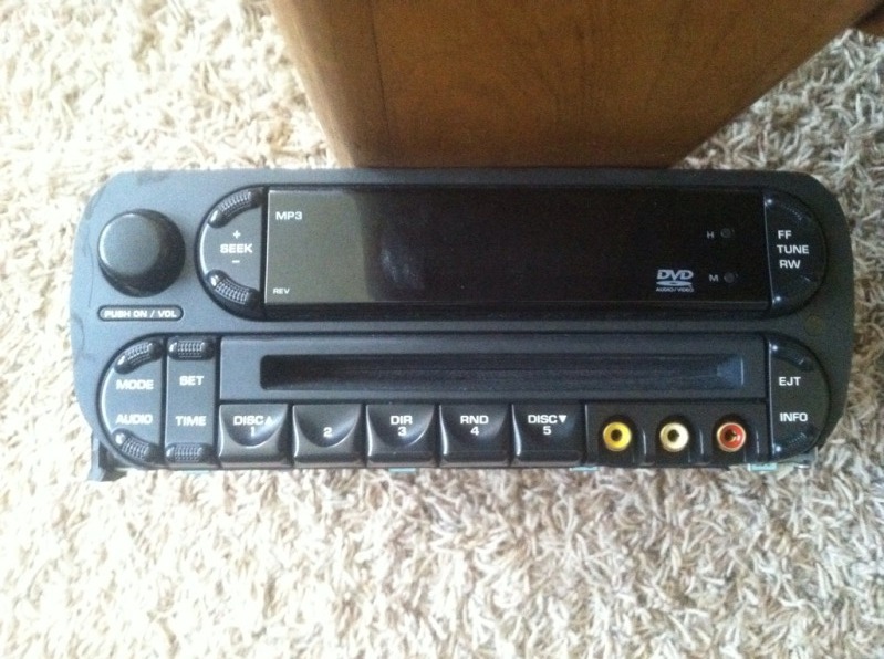

So I did some looking around and found this chrysler pacifica DVD unit on ebay for 100 bucks

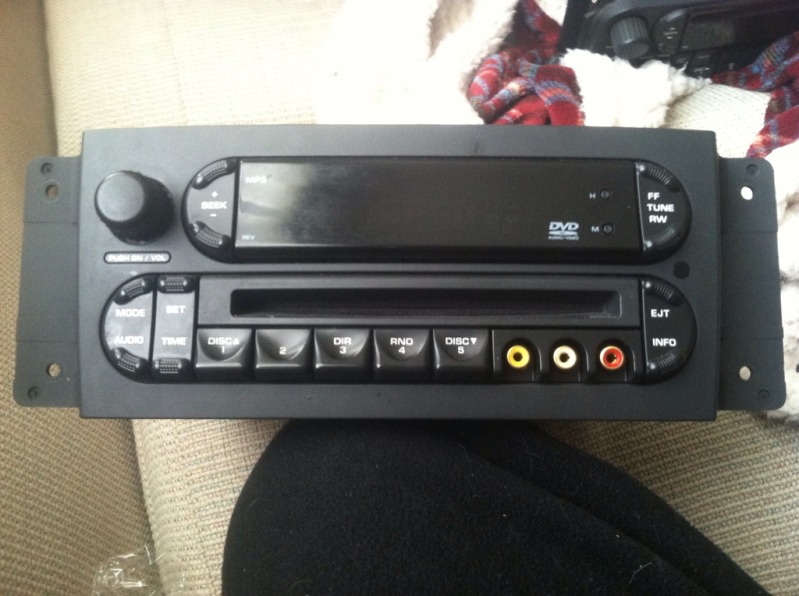

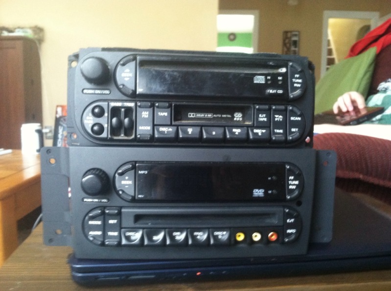

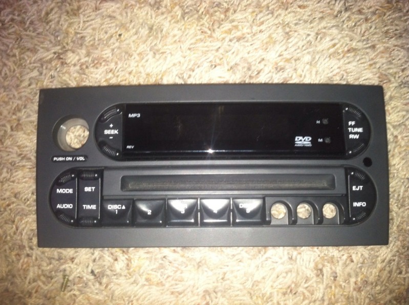

The first thing that i did was cut off the pacifica mounting brackets.

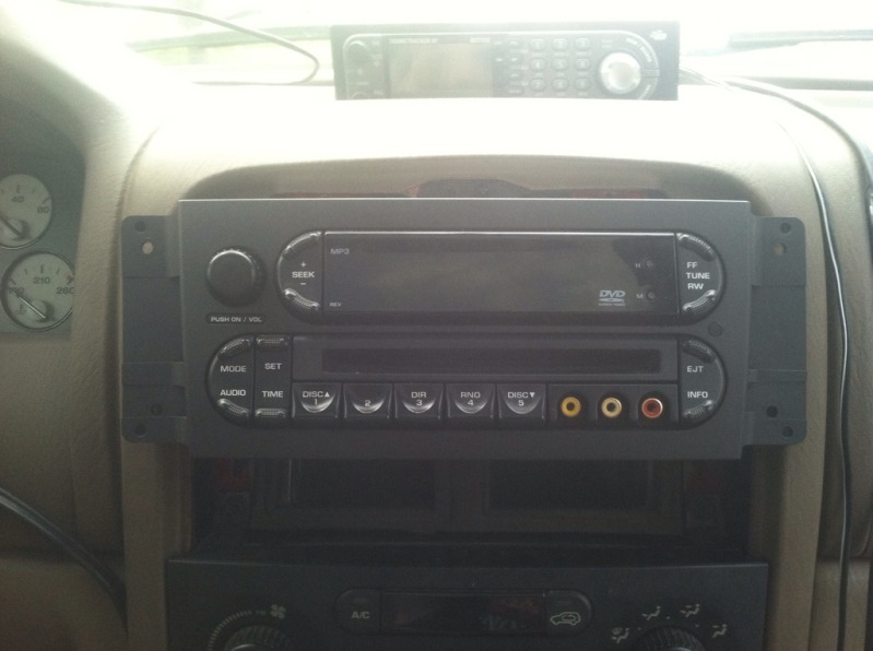

i then put the dvd unit in back the jeep and sat the bezel over the radio then traced around it to trim off the extra that i did not need.

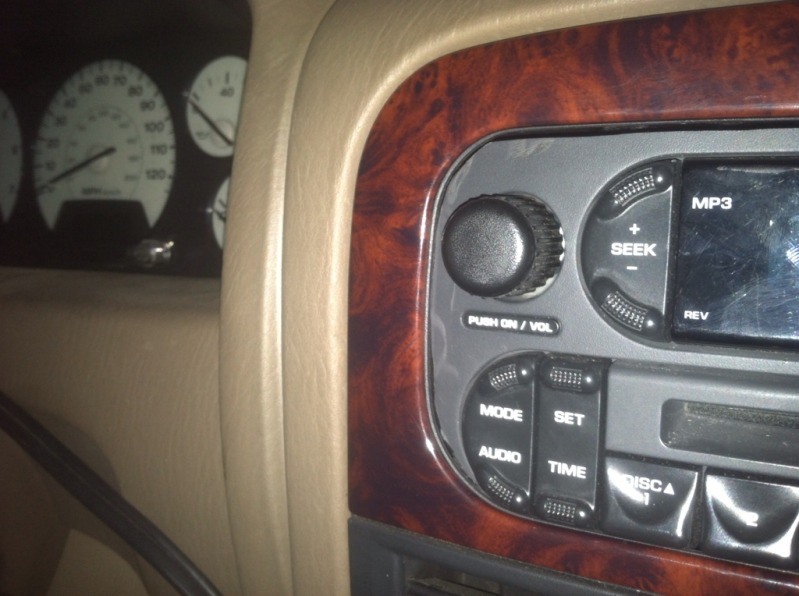

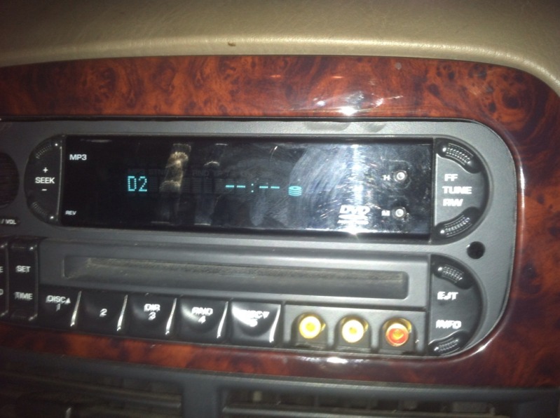

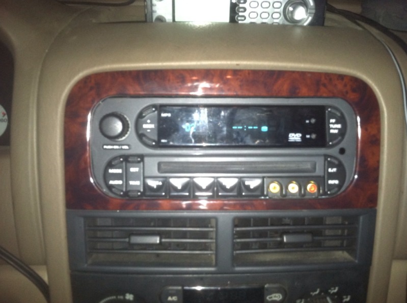

Now the finished product.
i still need to do build mounting brackets and add some screens i want to add 1 up front and 2 in the back. also looking at adding the 6 disk DVD changer someplace.

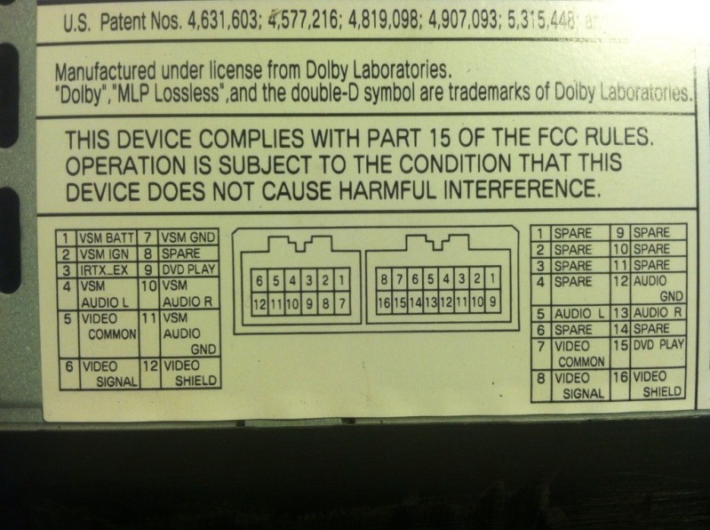

Since i am keeping the install 95% of the install OEM i am looking for detailed wiring diagram's with pinouts of the WK XK and the pacifica radio and entertainment systems. if anyone has them could someone PM me copys please PDF's would work best.
