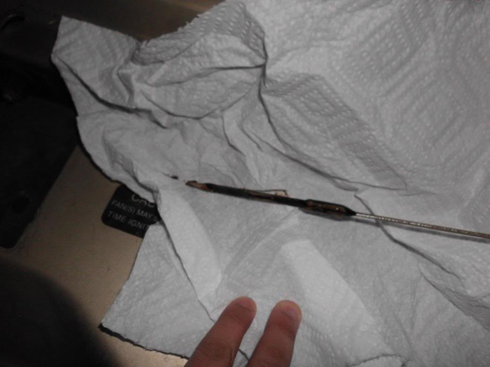

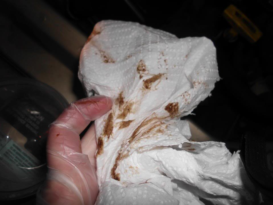

Old Feb 24, 2012 | 11:33 PM
agent00kevin's Avatar
Joined: Feb 2012
Hopefully image codes work here :P
Old Feb 25, 2012 | 12:32 AM
Joined: Feb 2012
What leads me to believe this is sludge or water pump leakage is the fact that its not fully mixed as you can see, and she has driven it for 1.5 to 2 hours AFTER finsing out about it. That and you can see the sludge is only present where the dipstick is likely to contact the sides of the tube and near the bottom of the oil pan. Its not in the center part of the dipstick, where it wont be rubbing on anything on the way in/out and is higher up in the oil pan.
Sounds logical to me at least.
