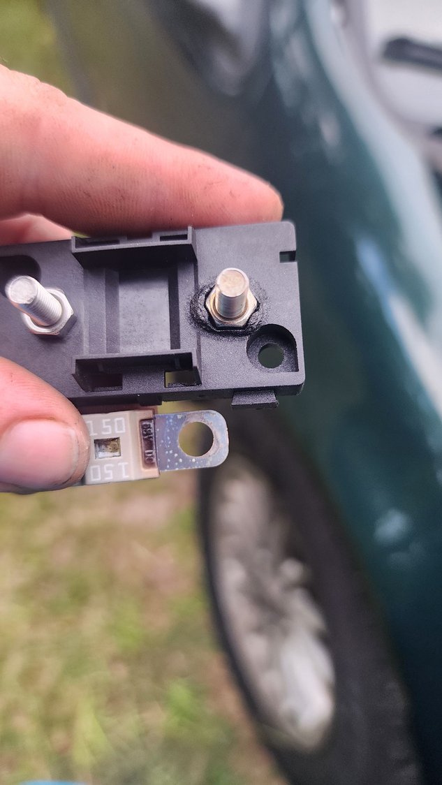

The 98 lxi is tossing the battery light on sporadically again. Didn't have an issue all winter. Then the heat hit and it's back. I had the battery tested it was bad so i replaced it. Put a new alternator on it no fix was getting no charge. Went and had it and the original tested and both came back good. Last night it came on I drove the last 2 miles I needed to. Jumped out and checked voltage and I was at 13.2 at the jump posts and could here the alternator frequency Humm. Went out to drive the car today got 5 feet battery light came on. Went to check voltage at the jump posts and I was at 12.2. Killed the car re cranked and I was at 11.9. I have replaced power cable, fixing to replace the ground. Ran a new alternator line to just check if that was the case and nothing. Fuseable link on the original was kinda burnt. Replaced that link with more fuseable link so now I have 2 alternator lines and still the same.
Ssr fuse good automatic shut relay good fuse n good. Alternator is not triggering. I out the other alternator back on that was good and it always gave a definite wine when it was charging and nothing. Not voltage out or anything.
Any ideas. Don't have much money to dump into the car and I can't just go get another vehicle either...
Photo is of the fuse in the second alternator cable i ran.
