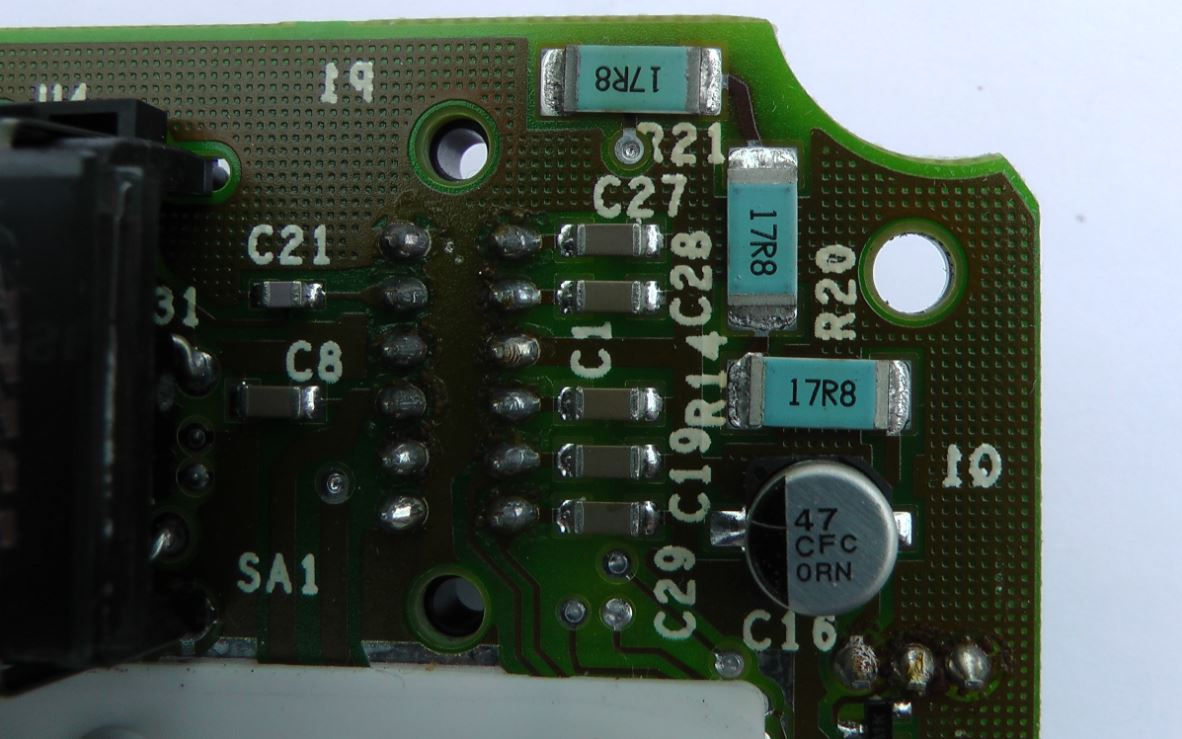

Solder joints notorious for failing on these controls.

This one is in the General Forum. Open up unit and resolder the 3 blue resisters. Poor/cracked solder joints may not be visible but are a common cause.
