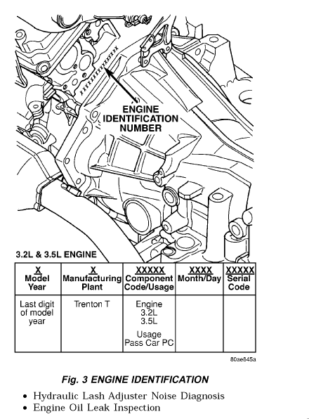

Old Jun 21, 2017 | 09:17 PM
FIREM's Avatar
Joined: Sep 2012
Posts: 534
From: Myrtle Beach SC
Engine Identification numbers are on the rear of the left bank block, just below the head deck. (drivers side)
The row of numbers that has a "T" in it is where to look, the first digit is the last number of the block year, followed by the "T", which is the casting plant, Trenton.
Next 5 digits tell if it is 3.2 or 3.5 and car it is/was in, next 4 are the month day of build. last 5 are the engine serial number.
Engine serial number usually does NOT match the VIN but at least you can tell year and date built, should be close to body date code on drivers door

am i correct that this would be a 2000 model 0T35PC01402
Old Jul 7, 2017 | 09:13 PM
is this for the 07 engine or the one in your 300 now?
Old Jul 8, 2017 | 05:55 AM
FIREM's Avatar
Joined: Sep 2012
Posts: 534
Could be......the number provided is incomplete yet the first digit indicates 2000 (or 2010)
