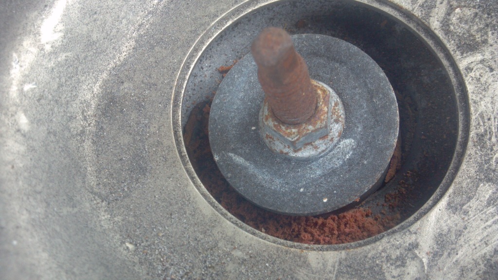

Also, maybe this is the cause of some of my current issues or could be the cause of future issues. The front strut mount bushings (believe that's what they're called) look really dried out ( and the struts themselves aren't centered but not sure how big of a deal that is), the front left one is in really bad condition, to the point where it is beginning to tear (Picture below).
Front left side (You can clearly see the rubber shavings from the bushing)

Judging by those pics, those are probably the original struts.
Do yourself a favor and replace them.
The clunking is probably coming from these puppies.

Replacing the struts requires some special tools. You'll need a puller to separate the upper ball joint and maybe a ball joint press to get the fork bolts out and then a spring compressor to disassemble the spring and strut. Nobody makes a quick strut for that car because the design has the upper arm and bracket holding it attached to the strut so it would all need to be included in the package.
With those shot bushings you really need to replace the shocks (struts) ASAP. If you have the tools you can do it, but get a shop manual to see what the job entails before you decide whether to tackle it yourself or pay a pro.

Your shocks are essentially non functional when they are so loosely mounted as that. You might be able to improve the situation a little by grabbing the very top of that threaded part sticking up (not the threads, but the area above the threads) with an appropriate tool and tightening the nut to compress the shock mounts.
There are shock absorber tools available that fit that piece. They are quite inexpensive. You'll want one if you decide to tackle this job as they make disassembly of the strut easier once you have compressed the spring.
