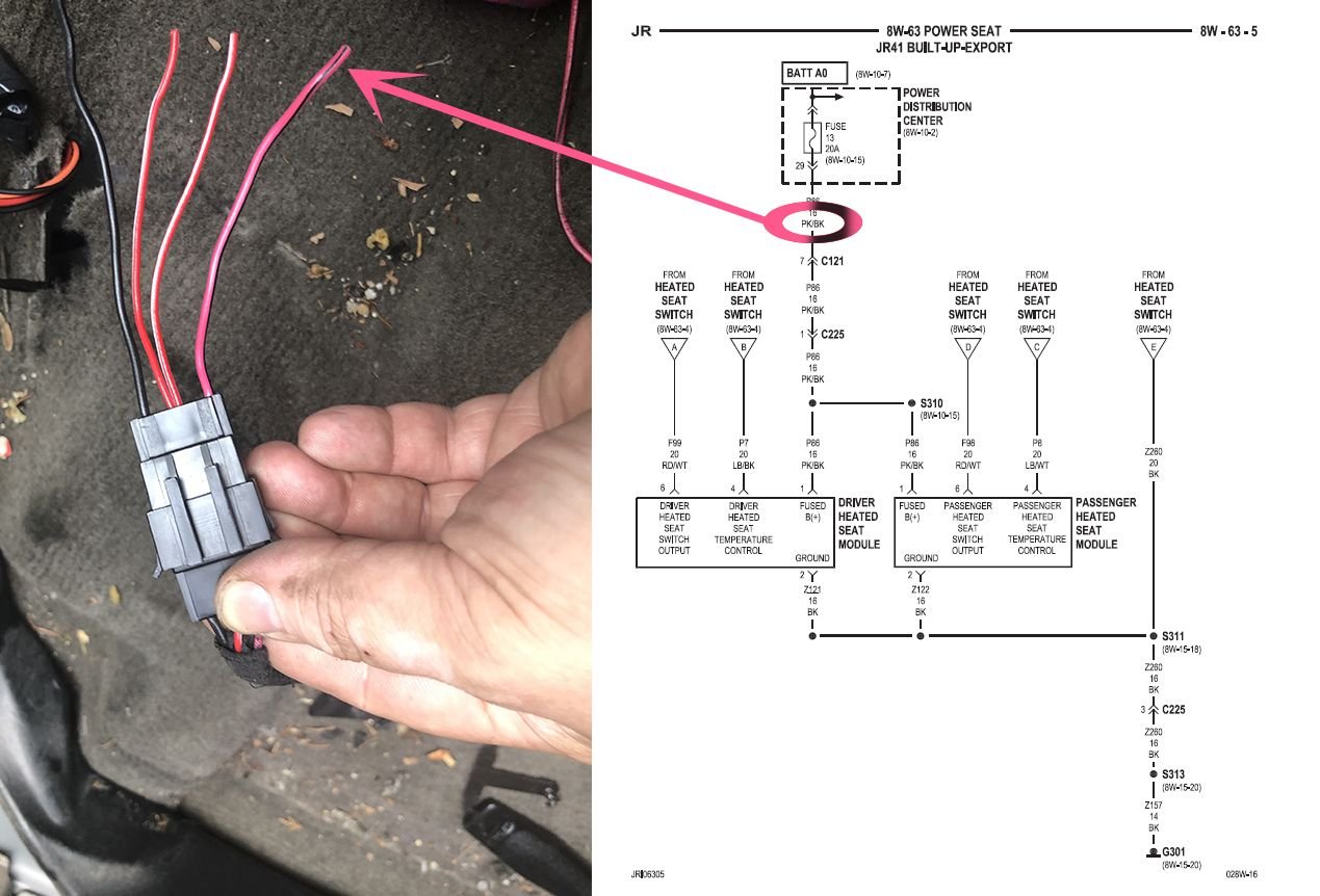

I would need to solve the seat heating. Sebring Cabrio 2.7 2002 EU version.
I originally got in the car without heating, but I bought from Limited with heating. But there is otherwise harness and fuses.
All cables, relays, modules, switches, etc. are there - just a single cable. The question will be more of an electrician.
On the left in the picture is the original connector from a convertible, where I got to the seat (also 2002, but I do not know if it was in the US) I have no cabling.
The other 3 know where to get involved, but I don't know where to put this pink-black (PK / BK). The service manual says it should go to fuse 13, but I have lights there.
The question is: can I connect this wire to the wire of the driver's seat? There are only 2 wires (red, black) and also has a separate fuse 20A. Or elsewhere or how do we get involved?
Thanks
