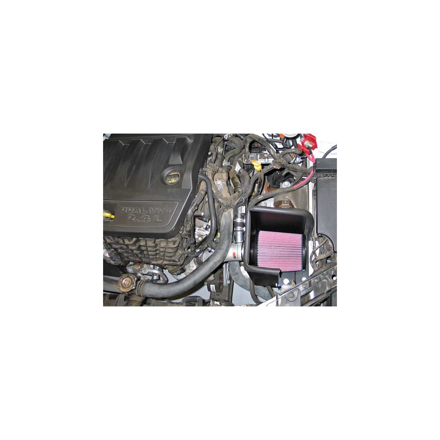

Does anyone know if either of the K&N cold air intakes listed below fit the 2008 Sebring?
Possible K&N cold air intake:
69-2542TS (2009 Avenger)
69-2549TS (2013 Avenger/200)
Same motor, same chassis... emailing K&N didn't help...

I was just under the hood, and I actually think the 69-2549TS model for the 2013 may be a better fit... my air tube goes OVER the top radiator hose, as does the 69-2549TS.
The 2009 model, on the other hand, goes under the top radiator hose (as seen in the picture I posted earlier)... and that just isn't how my car is currently configured.
