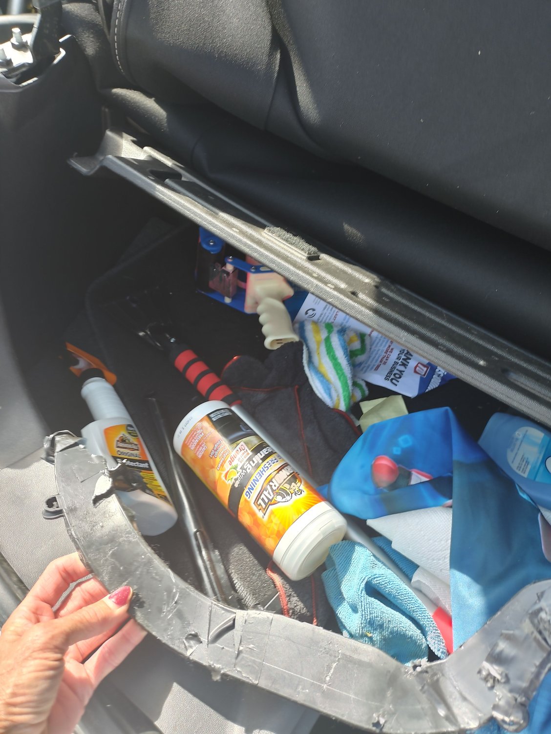

Default My wiring in my.convertible looks just like that .
Originally Posted by weldon11031
Yes sir doing it now
I have a Chrysler 200 convertible and my wires are hanging down exactly like that and constantly get caught while putting the top up and down, can someone tell me the name of the piece that is supposed to secure the wires PLEASE?
THANKS!!
This is half of the piece I am looking for.. the picture below is the opposite side.. wires should be between them .. I believe the 2 sides just snap together
