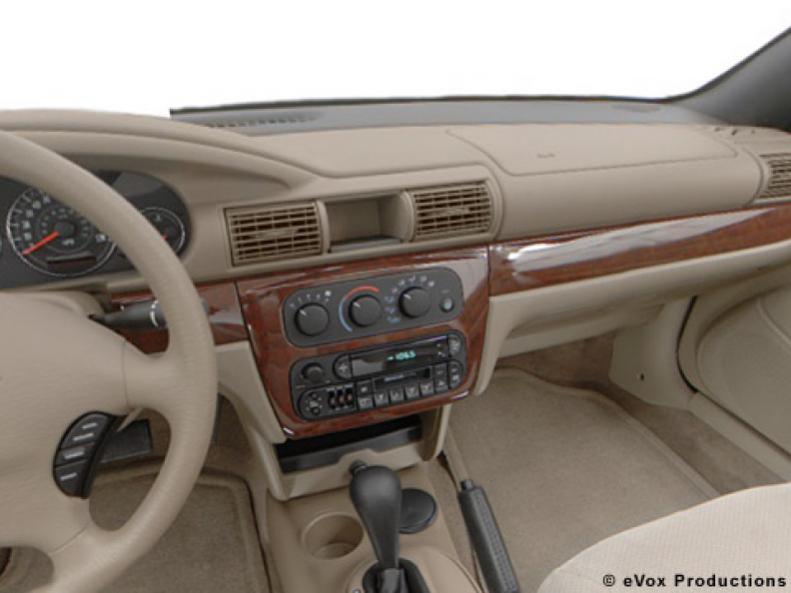

Hey guys,
Thank you for the replies. Yes, the radio has a specific button which is labelled CD/Tape. The tape player is housed directly in the radio assembly, while the CD changer sits within a bezel located in the lower dashboard compartment. Moreover, it readily accepted the CD changer's pin connector into the rear of the radio unit.
I have opened the CD changer unit up and checked that there is no CD stuck inside, which was what I had originally suspected the problem to be.
I have three theories at the moment:
1) The CD changer is broken.
2) The radio is meant to have a tape OR CD, but not both. Perhaps someone has seen a Sebring with both a working tape player AND a CD changer?
3) The CD changer can only be set up by an authorized Chrysler dealer as it needs to be programmed/registered into the junction box chip.
I have attached a photo of a Sebring with the same interior as mine. The bottom-right button on the radio is the CD/Tape button in this configuration.
Thank you for your time,
Leroux

Of your three theories, I'd bet on #1. Your radio looks just like mine, and I have a working CD changer. Yes, you can have both the tape and CD.
I don't think you need to set up the body computer differently for the CD. The radio, not the body computer controls the CD changer, and the body computer has minimal control over the radio. Does yours have the Infinity sound package? Is there an amplifier under the passenger seat? With the Infinity sound package, there's a sound profile difference for top up and top down on the convertible. Other than that, about the only thing the computer does is dim the lights along with the dash lights. Neither of those functions affect the CD changer.
You might contact the seller on eBay and find out if the thing was working properly.
