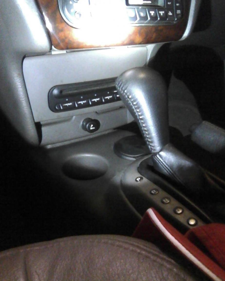

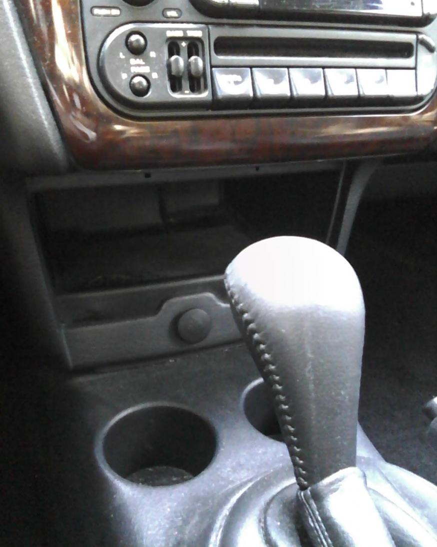

I have attached a pic of the 2002 which does not have the changer. It leaves a pocket for miscellaneous stuff. I assume the shelf is there after removal of the changer. If not, you can probably find one in a junkyard. The second pic is of the 2001 with the changer in place.

Good Photos...Thank You.
I scoured the internet last night and found a part call "Instrument Panel Mat." It appears to be the "Pocket" for where the CD changer would be. It is listed as "Without CD Changer." Lists at $18.70, for the $20.00, I'll roll the dice. The parts guy at the Dodge dealer said it sounds like it's the right part.
The Part Number is 04595756AA.
Looking at the 2 photos, I don't really like the appearance of the big opening. I may remove the faceplate from the changer and line the changer box/frame with some trunk liner carpet I have leftover from the restoration of my 68 Cadillac Deville Convertible. I like this idea. I hope I can get it to work.

Old Jun 20, 2012 | 10:38 PM
That "mat" may be a rubber mat that lays on the shelf. I don't think it's the actual pocket.
