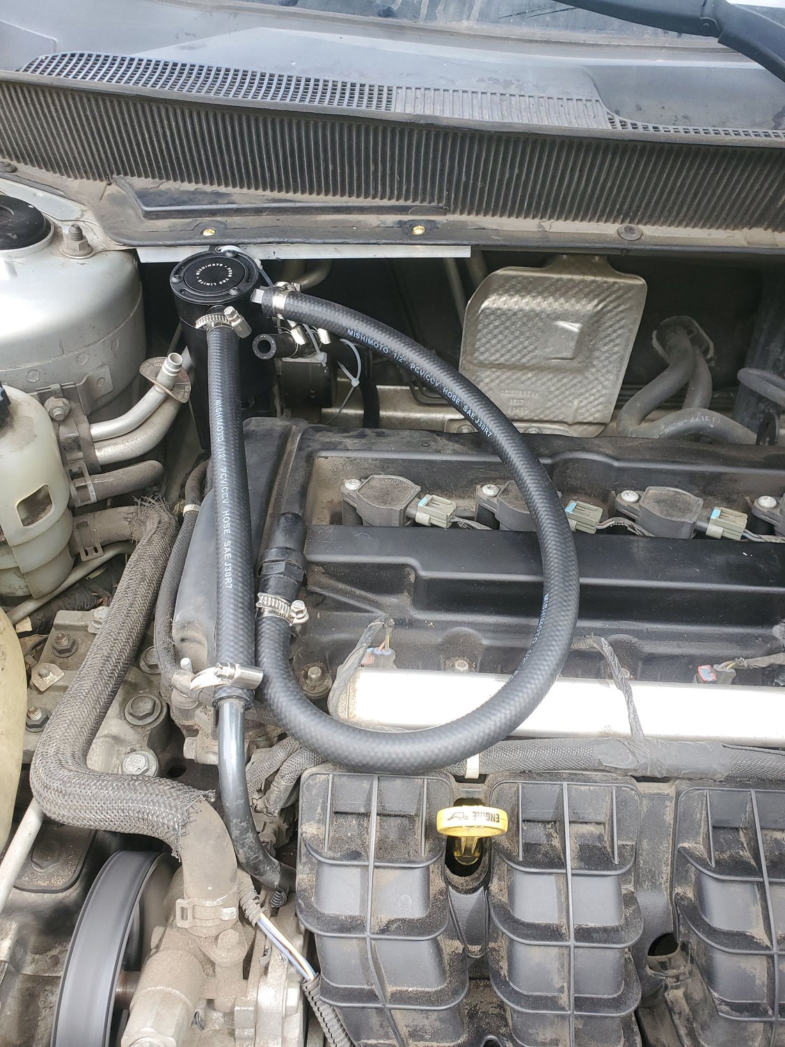

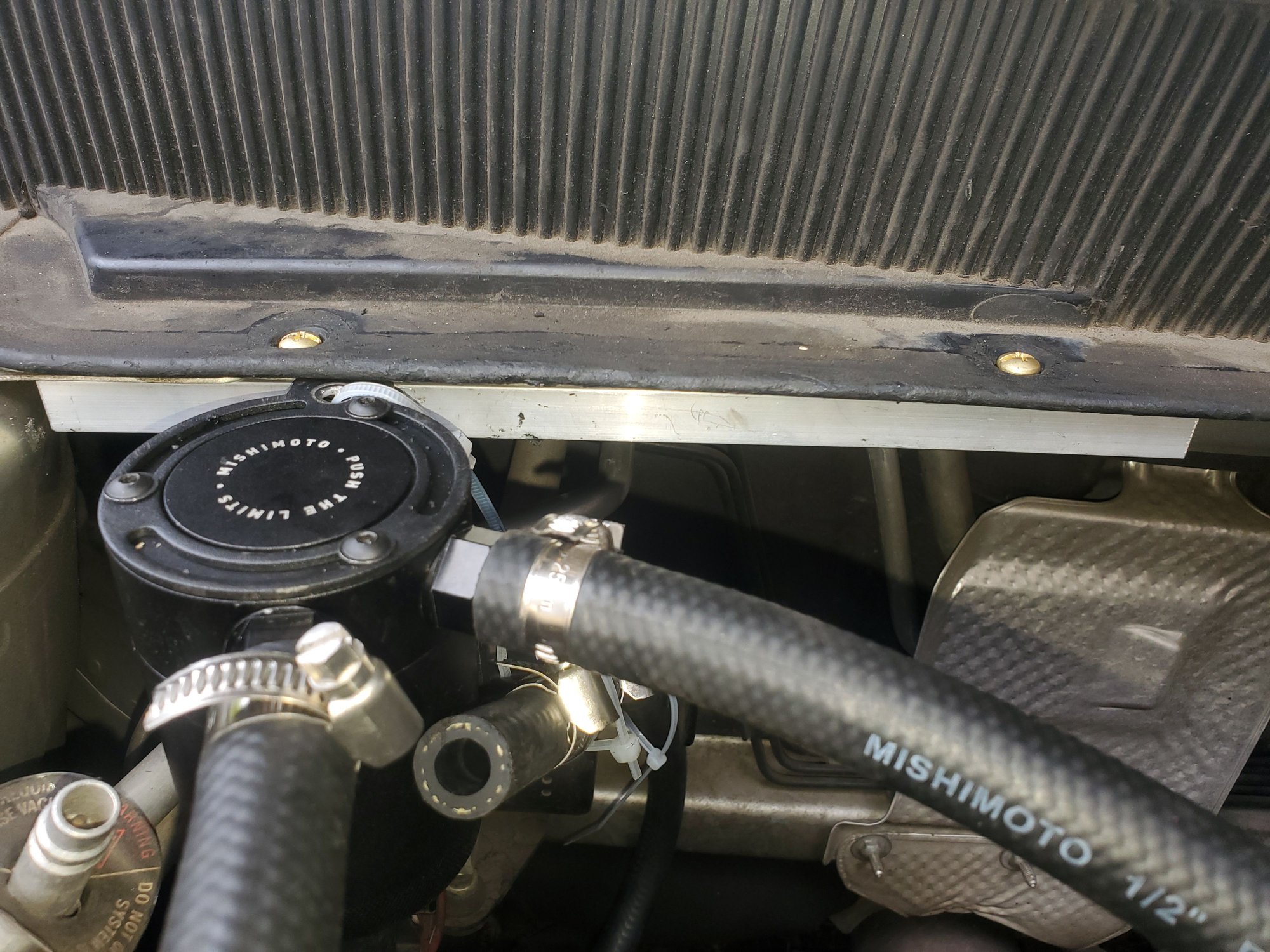

I couldn't wait for the shock tower brace to come in, so I went to home depot and got some aluminum angle stock to mount the catch can.
I undid two of the plastic rivets in the passenger side pinch weld above the firewall, and made aligned holes in my piece of angle stock. Before bolting the piece of angle stock in place, I mounted the mounting ring that came with my catch can, then used 1/4" bolts/washers/nuts to afix the angle stock to the pinch weld/firewall/cowl area.
I rotated the catch can to align the ports best I could, and bolted the can to its mounting ring. The outlet port of of the can ends up with a straight shot to hook up to the PCV tube that comes out from behind the intake... I didn't have to modify the PCV tube in any way. The inlet port to the can gives a pretty nice sweeping loop to the hose so it can connect to the PCV valve... I replaced the PCV valve with a new one while I was in there.
Be careful to "clock" your hose clamps so they do not make contact with anything... especially the nearby hoses themselves. I had to do some loosening and retightening of some clamps to eliminate contact. I also put in a spacer made of some of the extra hose cut lengthwise to go over/between the two hoses where they contact each other.
After a few miles, I went in and tightened everything again to be sure. Send it.
