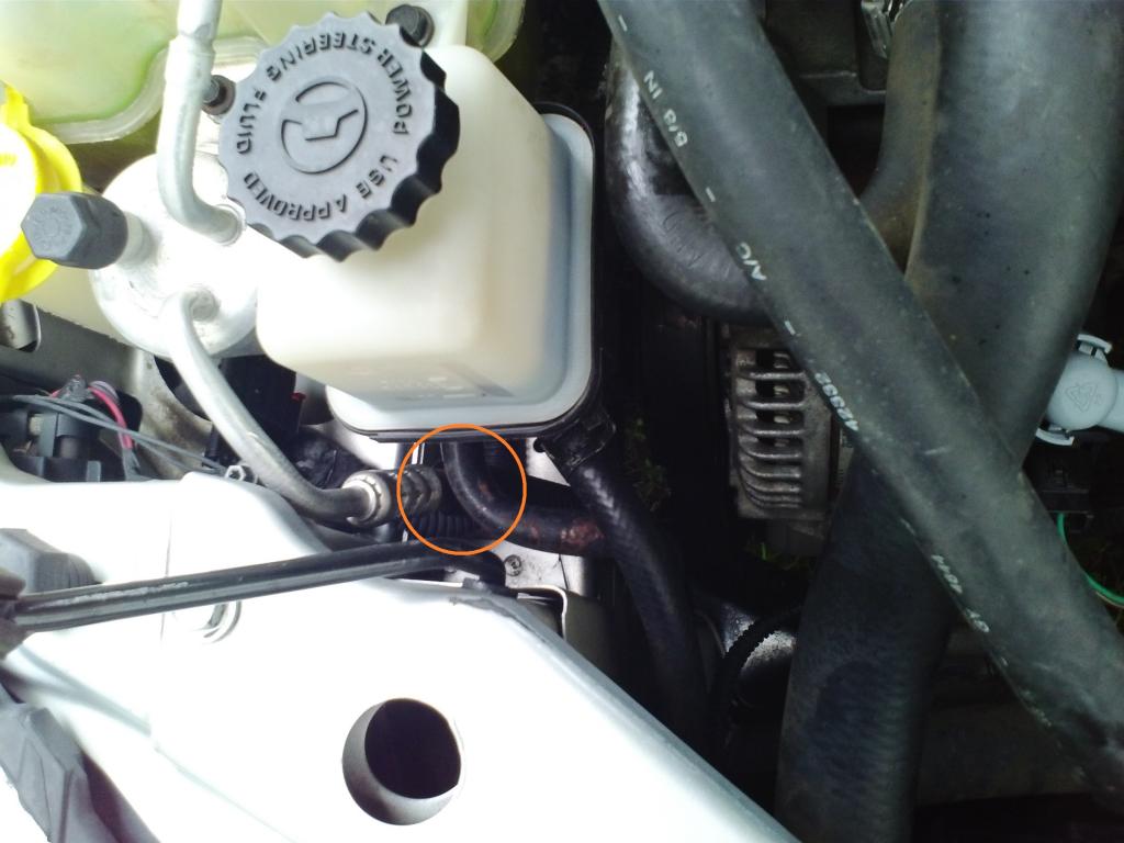

Thanks, dcotter0579. Good news. I took my car to the car wash and sprayed the whole engine compartment, after that, I checked for leaks again over the next day or two. I found it, but not where I had been looking. It turned out to be the little plastic reservoir. It had made contact with the alternator pulley and had worn a small hole in it (Yellow circle). I fixed the leak with JB Weld.
This leads me to another question. Should the hose (Red Arrow) be in front of the metal tubing (Blue Arrow)? The hose is preventing the metal tube from being pushed back far enough to allow the reservoir to be mounted properly, causing the reservoir to be closer to the alternator. The hose and metal tube are both part of the Air Conditioning. Is this how the factory installed it?Name:  019-1.jpg

My '01 looks different than yours. The blue arrow tube is actually a rubber hose on mine, and it seems to be routed better. See if you can find a similar car in a used car lot or junkyard and take a look at that area. Maybe they changed something in the design or maybe somebody cobbled something together on yours somewhere along the line.
