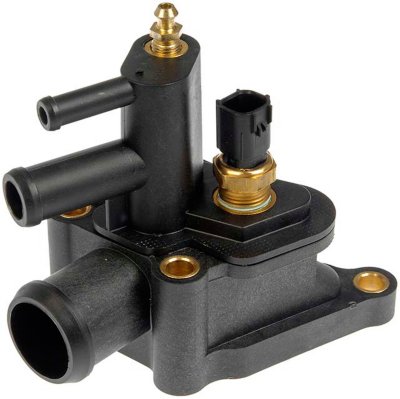

could be leaking from this..its called a coolant bleeder housing and its very common for the plastic to seperate, I just replaced mine last winter and I have also heard of others gluing it back together with JB weld
