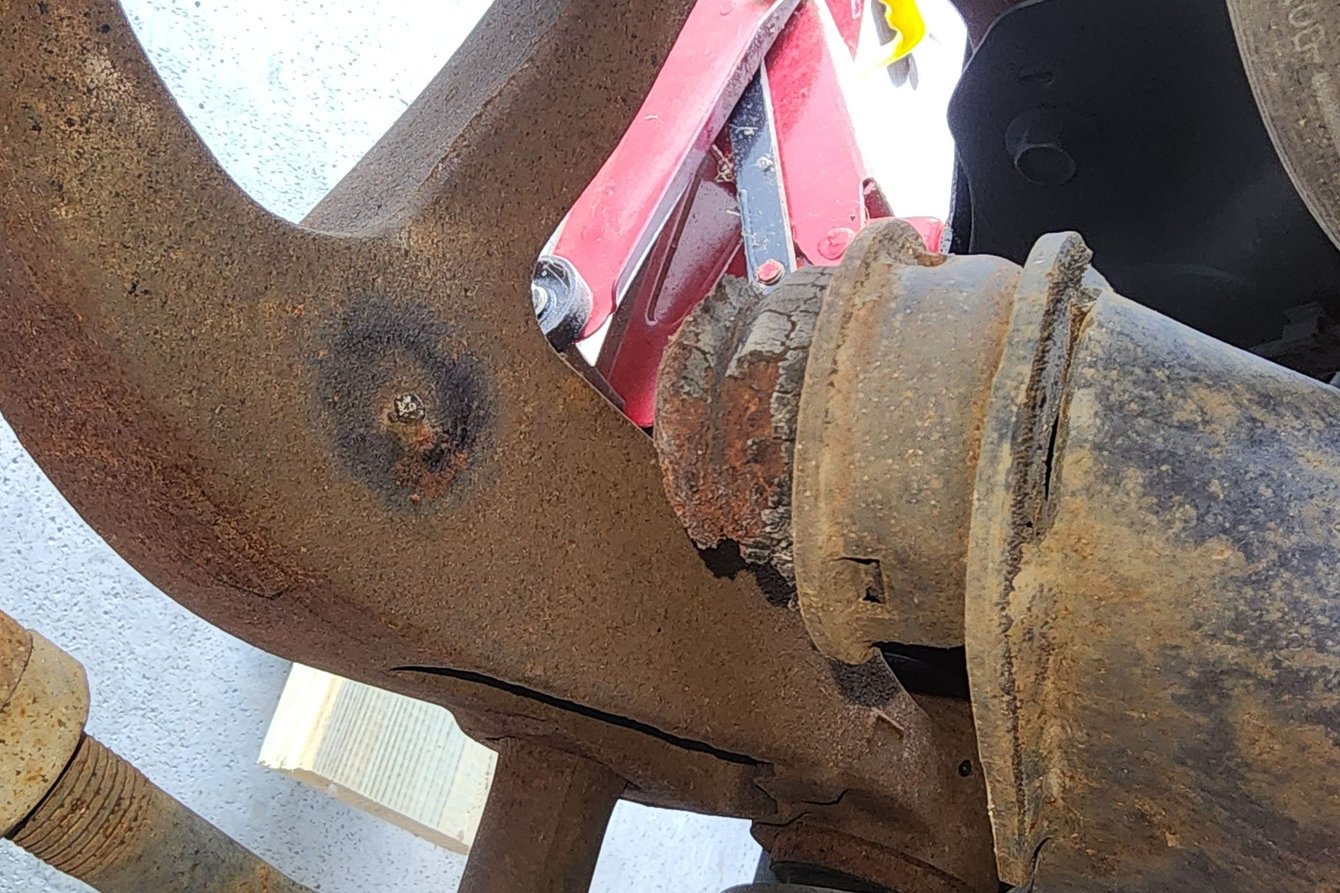

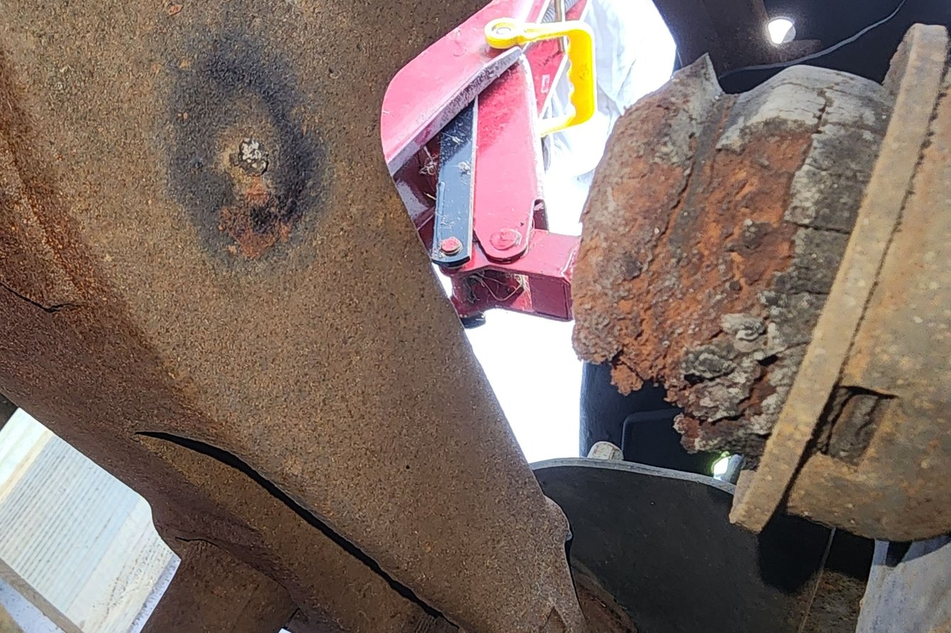

These rubber doohickeys (right side in pics) on both sides of the front suspension are tired. I think the Mopar part number is 52113218AA
Tired Bump Stop 52113218AA
. The sellers are proud of them at $28 each.
My question is what holds them on? Is there a bolt up the middle, are they pressed in? What is the process to change them out?
I found a seller but they only have one. I ordered it but will have to wait to find another.
Sorry the pics are so large and strangely placed. First time pic upload.
Thank you for your help!

This was an easy job. Dig out old, wipe area clean, dab some silicon around perimeter, push in, tug on it to make sure won't fall.
