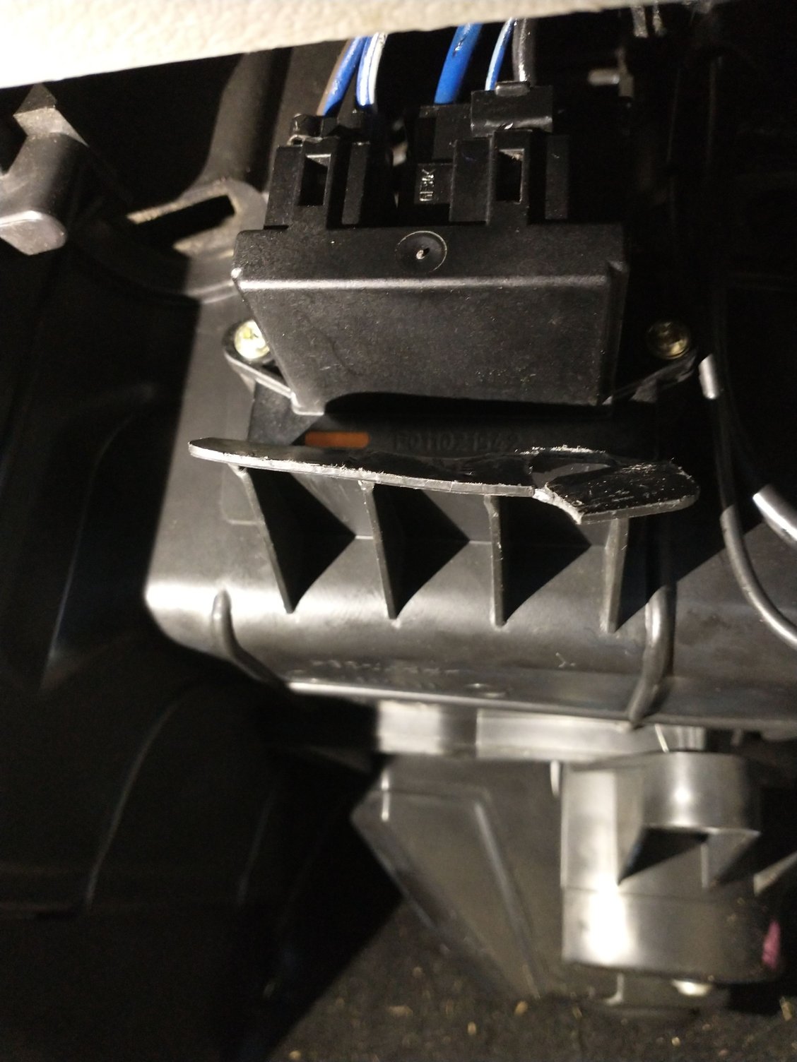

The Blower motor resistor is underneath the dash on the passenger sideunder the glove box. Look for a wide black plastic tab sticking out. It's above it.

I replaced the resistor but no change. No power to blower motor. Maybe ground? Wiring diagrams/schematics are sad.
