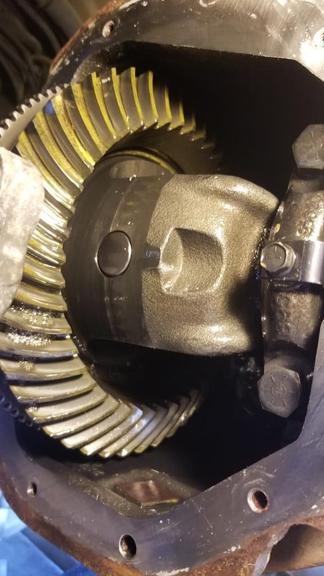

My 2007 5.7H 2WD 3.92 Rear-end Aspen with 110,000 miles has developed over the past few months a whine in the drive-train. I just changed out the differential oil [Valvoline full synthetic gear oil 75/140] and saw nothing that I could recognized as wrong (a couple pics attached). But I know not about drive trains.

Diffs are simple metal parts. When wear/play occur these shed small metal dust/flakes.
You can drain a diff and simply take a magnet and swirl around the old fluid ( yes it sticks to the covers etc) point being it'll attract these flakes. Failed parts will have alot. You're pics don't indicate heavy wear/damage.
Get it on a lift and locate the exact noise location and start there.

Thank you bradleybbb. I appreciate your insight. Though I own a shiny new Steelman 60635 to isolate the whine, I blew out a rotator cuff soon after I bought the Steelman and have yet to get back under the truck. Hopefully before the first snow. I suspect bearing(s) but which one(s), I have to find out.
