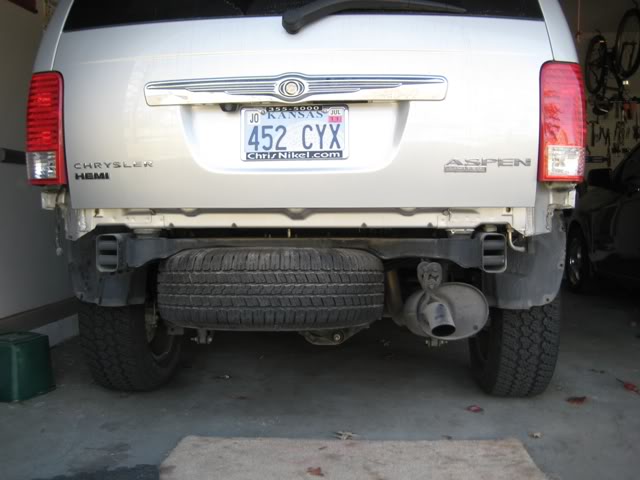

Some of the rear sensors removed. Hindsight, you don't have to remove them, nor each individual harness. The complete harness unplugs once you have the bumper mask removed:

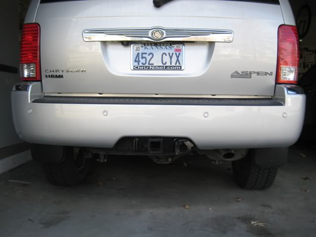

Bumper mask & rear splash gaurds removed:

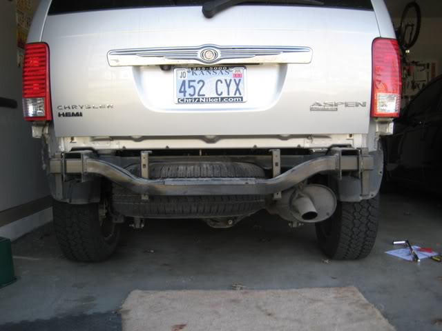

Rear cross-member removed:

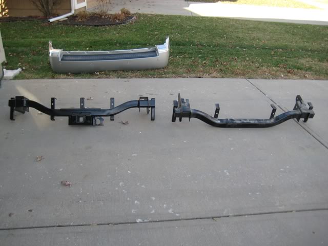

Pieces:

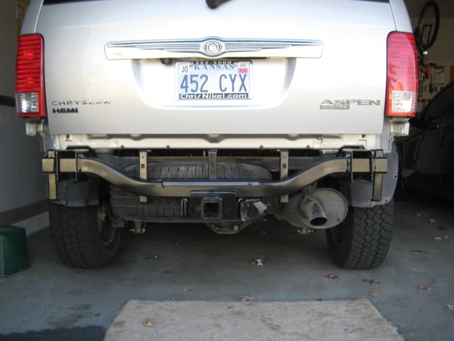

Hitch on:

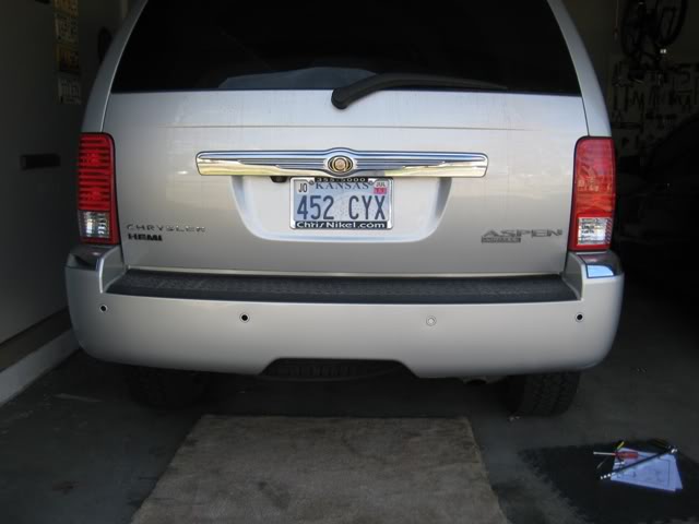

All back together:
I've since bought the Mopar hitch plug as well.
