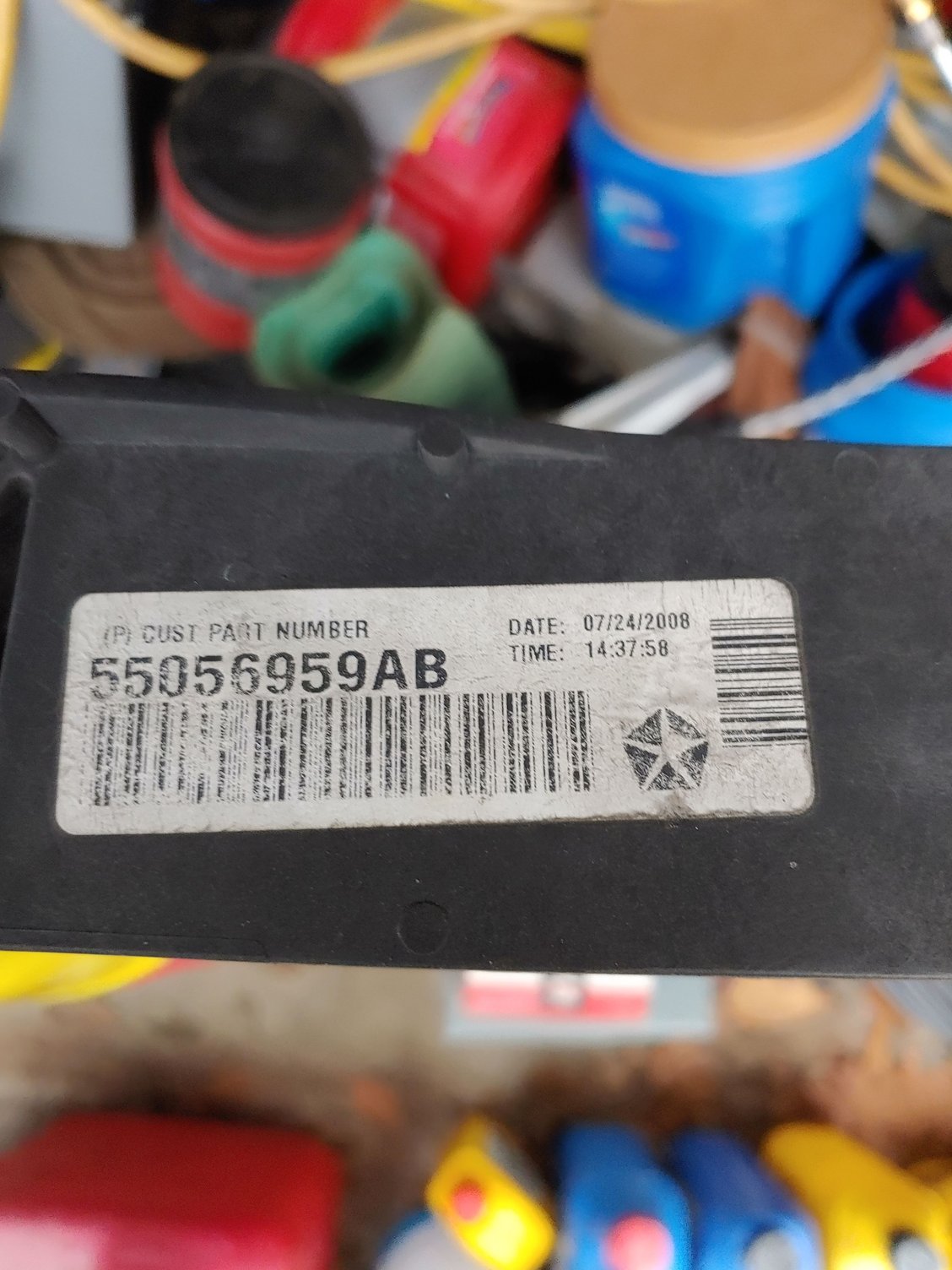

Here is the picture I took of the side support of my radiator. The Chrysler place said it didn't return any results in their system and when they searched the aftermarket places, it shows it to be for use with the 426 Hemi from the 60's. Needless to say, I'm very disappointed with the help I have gotten from Chrysler.

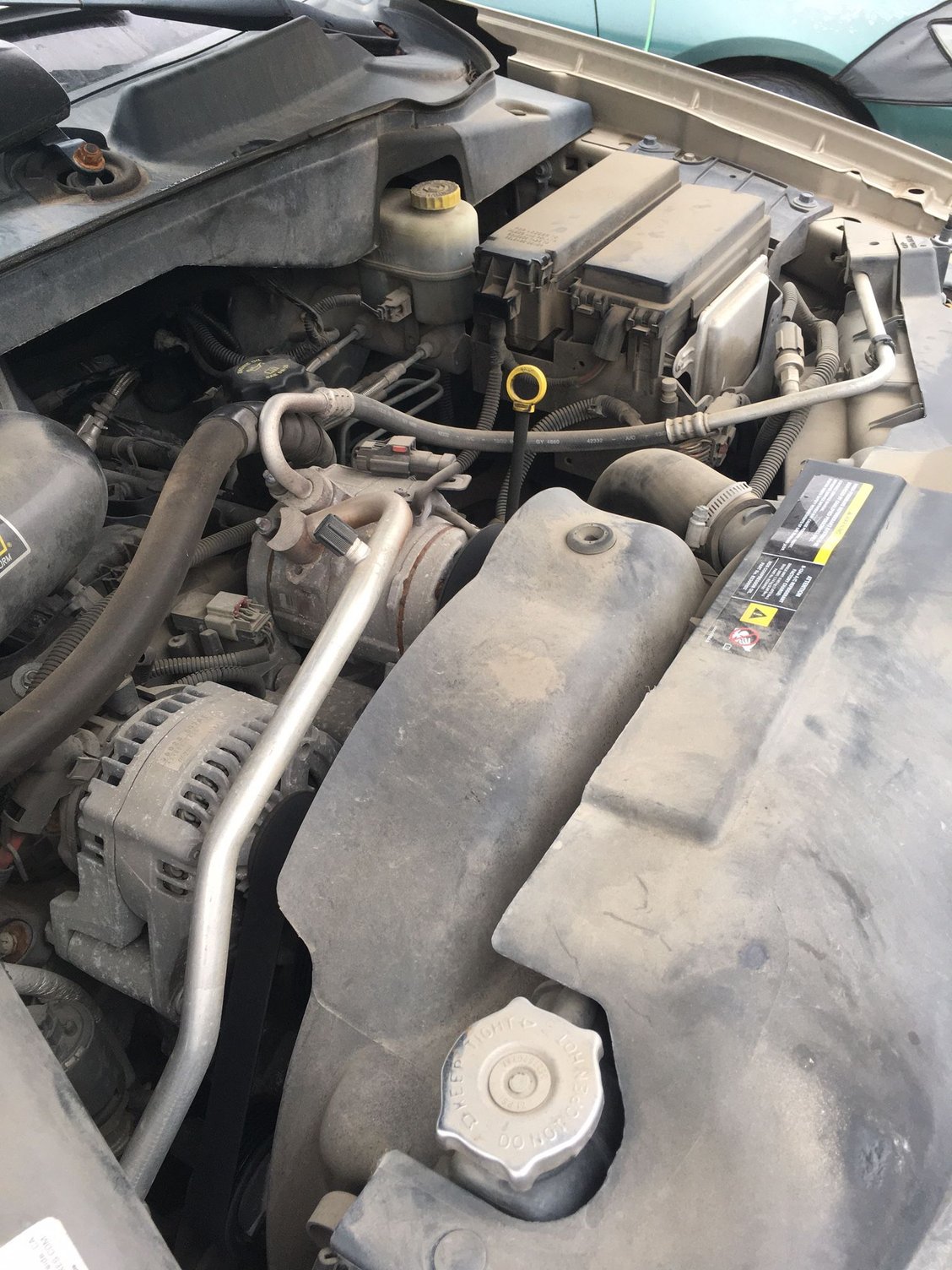

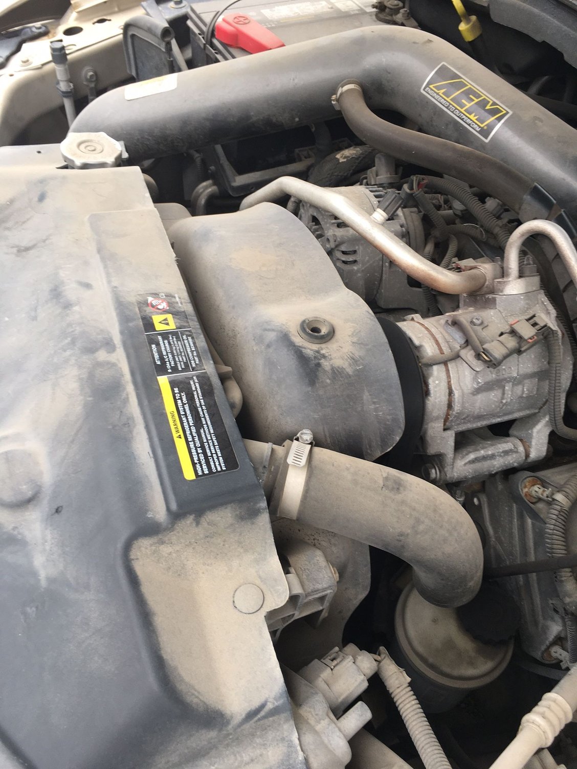

Here is the pictures of the used radiator I have on the way...
