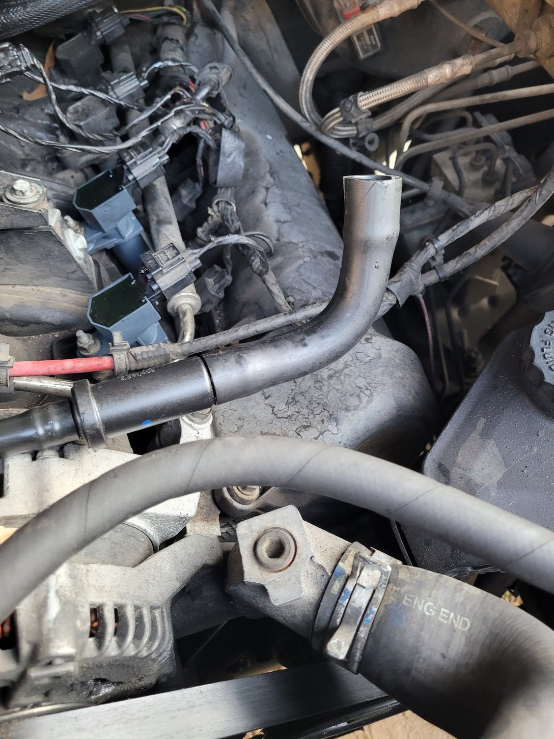

Was changing out spark plugs and coil something I've done a bunch of times I used to just disconnect the one in on the left side near the battery from the cold intake at the air filter box I have no need to disconnect the whole thing this time it was time to finish up put everything back together again but I guess I need to bump something to pull it too hard and the whole thing came out I cannot figure out how or where to reconnect the part the end of the pipe on the right side please help need to use my vehicle again thought it was going to be a simple procedure I've attached pictures and a link to a video if anyone can help me I have a 2007 Chrysler Aspen 4.7 L Flex Fuel V8 thanks

This appears to be a hose for the PCV system. I believe it is the air makeup hose which pulls air from the air filter and into the engine. This hose should connect to a valve cover either to a nipple on the valve cover or to the PCV valve itself attached to the valve cover.
Hey thanks for the help but where is that located? I have looked everywhere on my engine and I don't see any where a nipple or even a connection would be to plug it back into

According to this diagram, the hose runs along the right side to the back of the engine. Guessing at the year as it was not included..
https://www.moparpartsgiant.com/part...agram=i2174513
