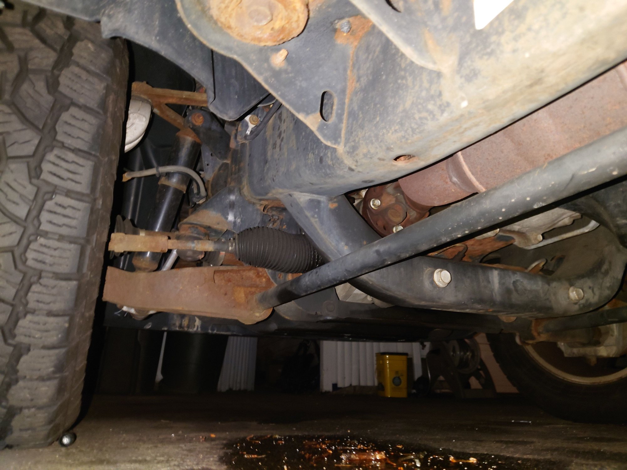

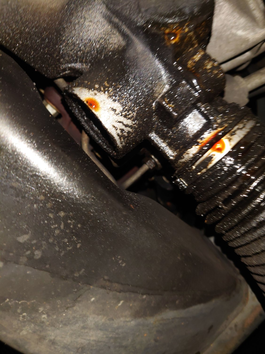

While I'm installing the new pump a week later, I see the reservoir in the old PS pump is empty, and a big puddle under the car.

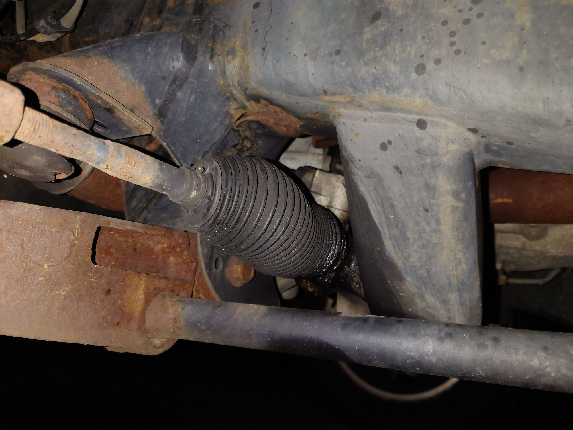

Looks like power steering fluid has leaked out of the steering boot.

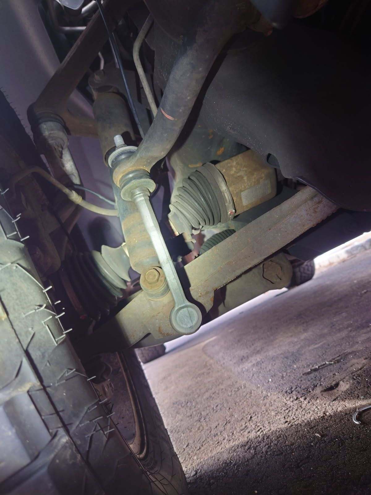

And then I notice this...seems like the new sway bar link broke?
So I'm wondering..
Is the broken brand new sway bar link, snapped belt, and leaky steering bellows related? Did one cause the other? Or are these just 3 different issues coincendences?
I'm going to the dealership to have them replace the faulty link, but would cause damaging to the steering rack?

steering  boot leak drivers side
steering boot
steering boot
bad sway link drivers side
good sway link
good sway link
drivers side bad sway link

If I had to guess, I would say the belt snapped because the PS pump was locking up due to being low on fluid. The sway bar link being broken is unusual for sure. You will need to reseal or replace your steering rack before you get back on the road with it, or it will happen again.
