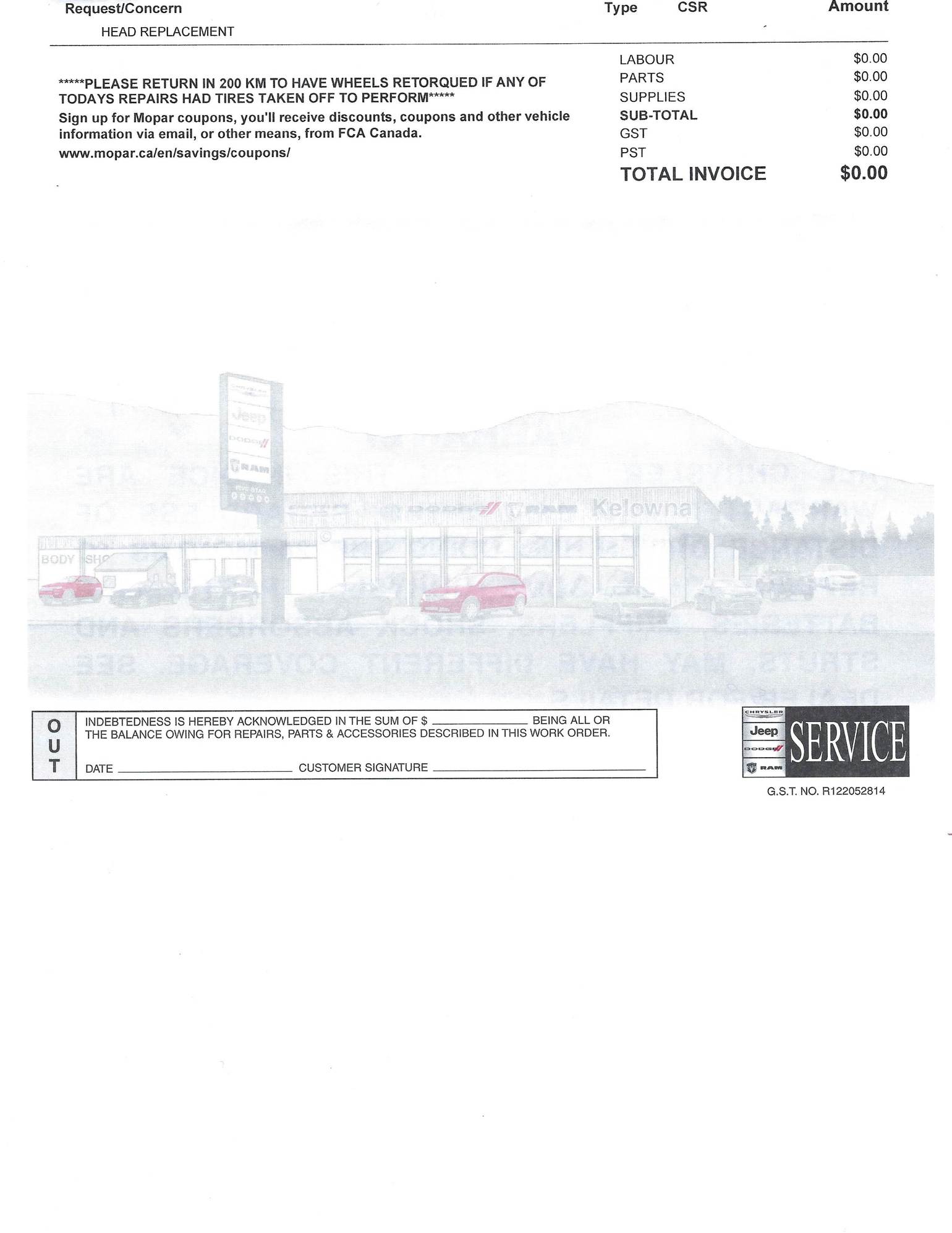

Default cylinder head issue
documents from my 2017 pacifica repaired under the 5 years emission warranty
Scans are in numeric order with details of dealer/client cut ott

hi,
I posted some info for you. I had the same issue with my 2017 Pacifica in 2020. Starts out as you describe, a stutter, a feeling, that will go away. In a while, your van will throw an engine code that is defined as "engine misfire". The original thought from the service tech was not followed up on...they tried many things over several months trying to diagnose the issue. In the end, they did what was described in the service invoice I posted - it is what the service tech described on my first visit about the issue. It took about 90 days to get resolved. Hopefully this info helps.
