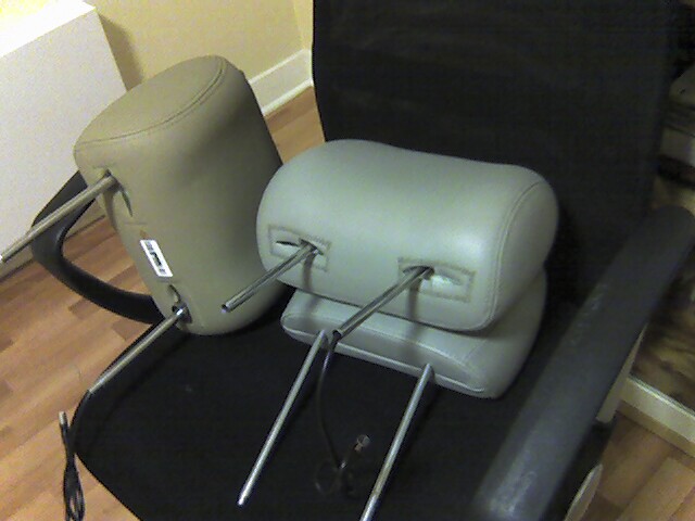

Until then, Phase II:

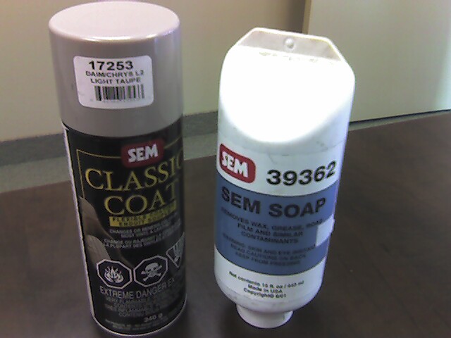

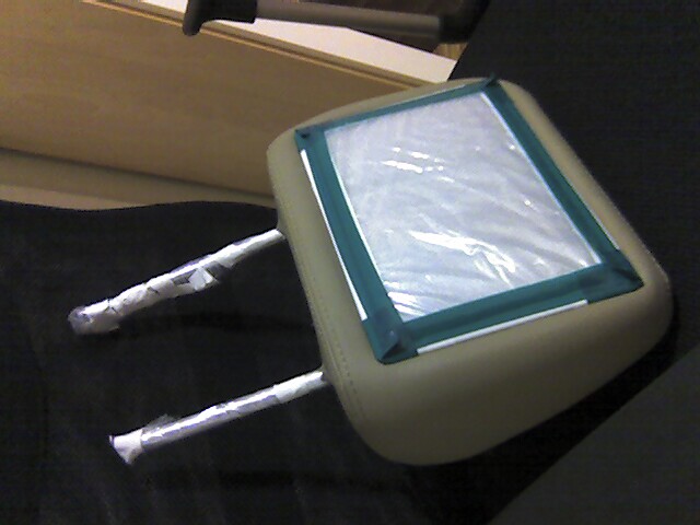

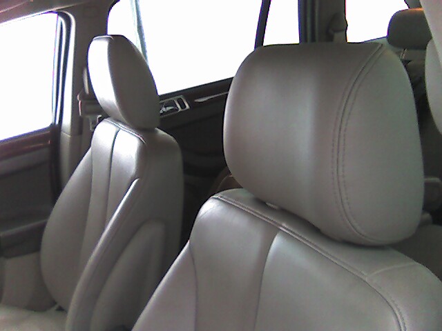

So I ended up doing a complete masking job prior to spraying:

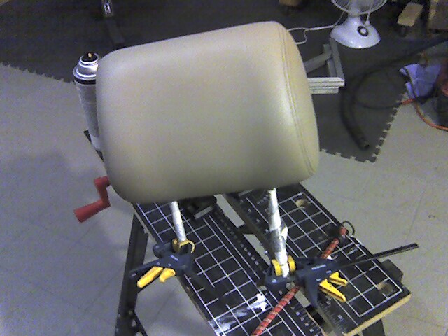

next I set it up in the garage: (this is with the first coat)
after applying 5 very light coats: (bottle says to apply 2-3)
left is original, right top is sprayed, right bottom is OEM headrest pulled out of the Pacifica.
All I can say is WOW. This thing is amazing. 5-10 minutes between coats. They call it a "coating", but it's nothing like spray paint, it's acetone 30% so it sinks into the material and ends up looking like an original color.

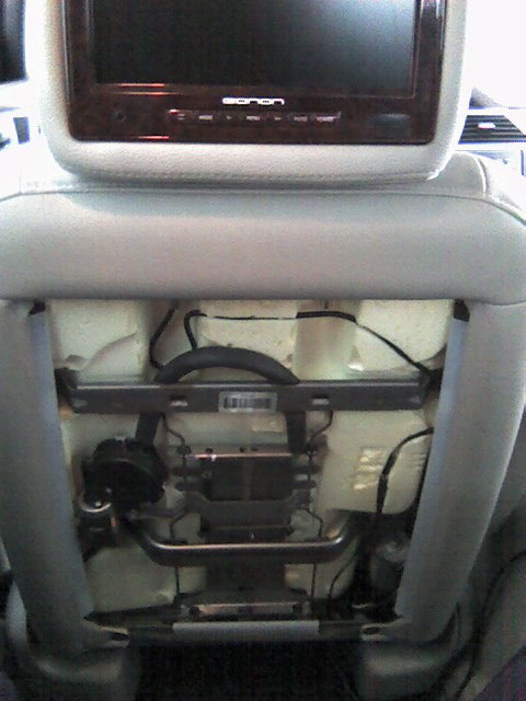

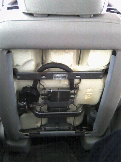

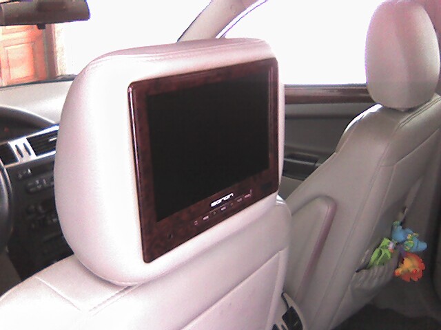

So I decided to prop the back off the front seat. I broke one of the 6 side anchoring snap hooks but it's the middle one. I'll glue it back someday... and this is what I found:
So I figured I may as well trace a path for the cable that won't interfere, so I chiseled into the foam and recessed the cable inside nice and snug. there are holes in the bottom metal frame of the backrest. That's where the cable exits.
Snapped everything back into place, and voila:
The shape is different than the original, but once they are both in place it should look pretty nice.
I now need to finish headrest #2, and hook the wiring into the center console. I'll probably merge everything under the cup holder or on the sides of the console as there is hollow space underneath.

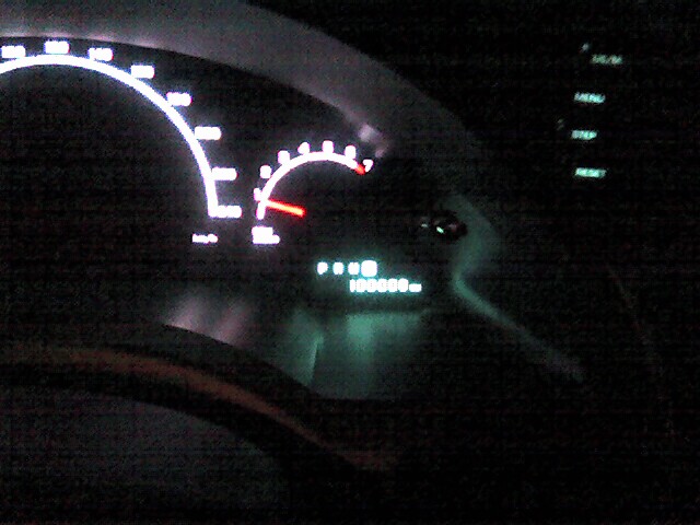

Almost forgot:
within the 1st hour of the 1st day of the 1st month after 10 years in the new millenium, the Pacifica turned 100000 Km.
It's a sign look at the name of the image: Photo_010110_001.jpg hehe...
Happy New Year everybody!!!
