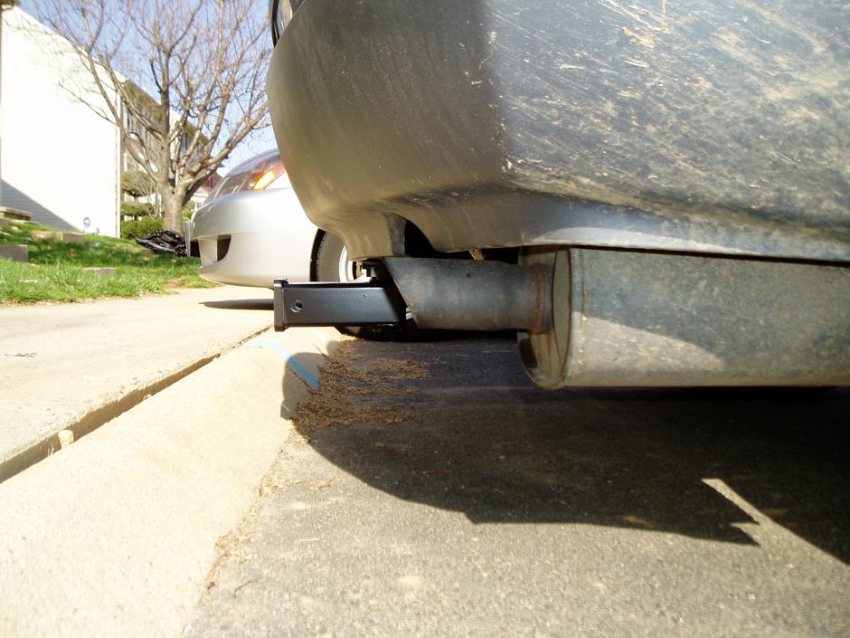

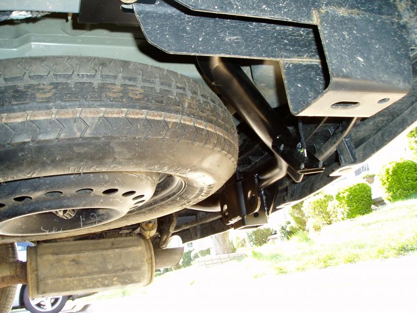

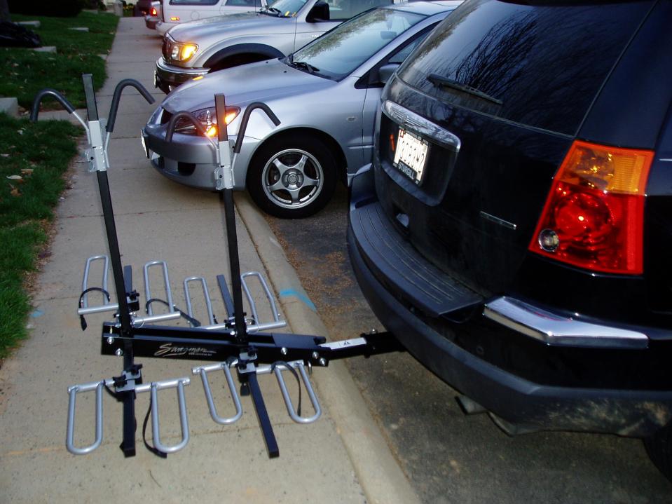

Old Apr 3, 2010 | 11:30 PM
pac2006's Avatar
Joined: Apr 2008
Posts: 76
Here are some pics. I don't have the anti-rattle hitch pin yet. I will test it soon with the bike carrier.

Old Apr 4, 2010 | 01:52 AM
mrfixit454's Avatar
Joined: Jan 2007
Posts: 531
That looks real good. Is the vertical a new design? I have seen some on pacs where they cut a little of the bumper off and some that still clear it horizontally. With yours, you won't even know it is there when the hitch is off.
Old Apr 4, 2010 | 11:10 AM
pac2006's Avatar
Joined: Apr 2008
Posts: 76
The vertical is the current design. I wanted the original where you cut out a piece of the bumper trim, but it is no longer available. This one is good when it is removed, but what I don't like is the extra play. I plan to use the bike carrier and a cargo carrier. We will see.
