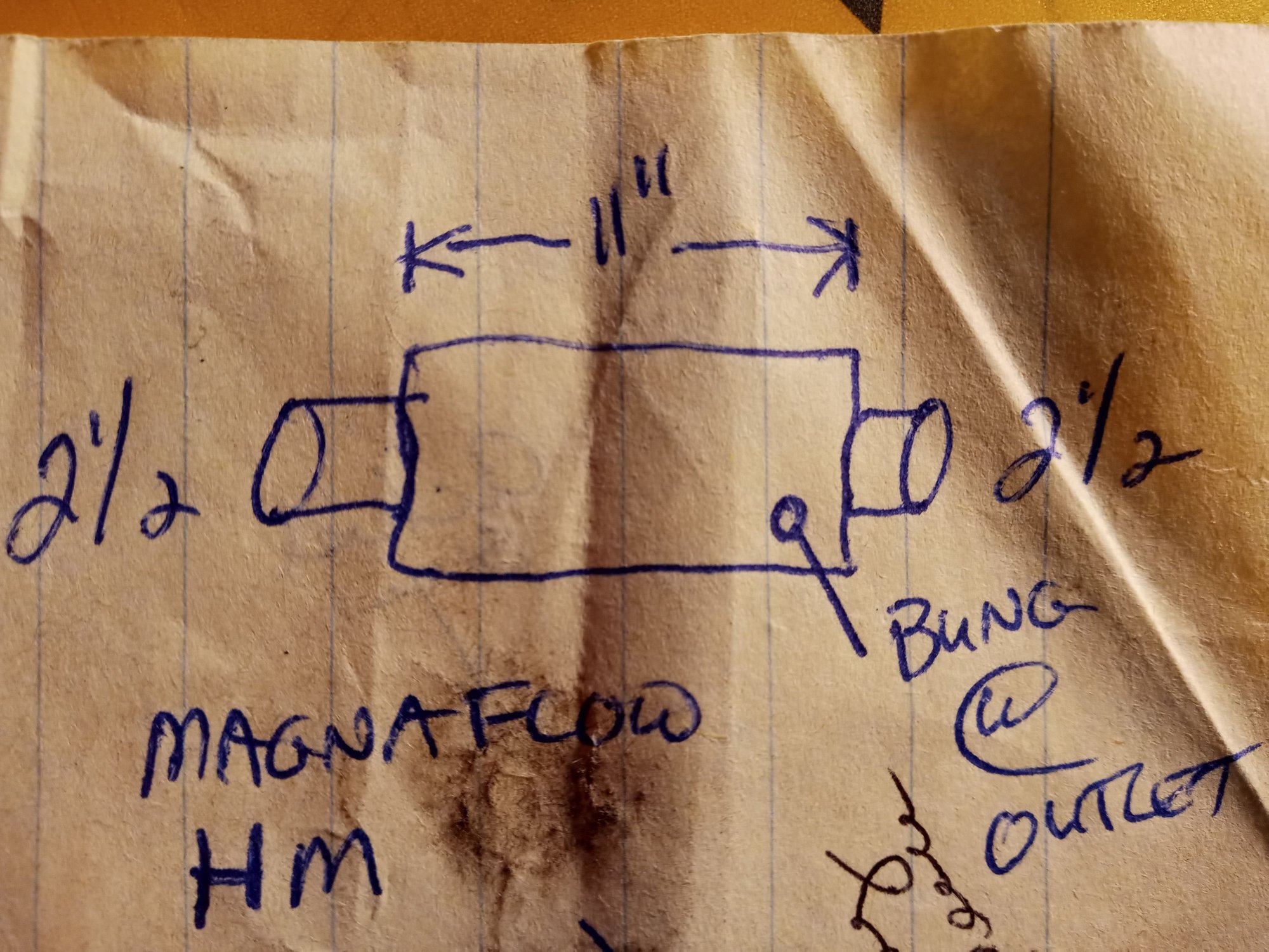

Hey Firem,
My mechanic want's me to order a catalytic converter with the bung to the rear. However, all the ones I find are in the middle. (See diagram.) Can you suggest a web-site where I can buy one and a muffler to match? I drive a 2005 Chrysler Pacifica 3.5 AWD Touring.
Thanks,
UberPacifica2005
