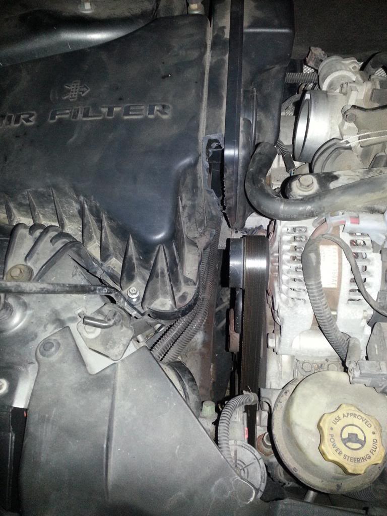

So, we were driving to dinner the other day when I turned a corner and heard what I thought was something rolling across the roof the of car, but it just kept going. Suddenly, the car ran rough for a short minute, the check engine light blinks on and back off again, then the engine jump up to 3000 RPM's and stays there.
I turn around and go home and pop the hood. This is what I see(yes, this was after I too the intake hose off). Big gash in the hard plastic air box and part of the hood insulation is ripped.

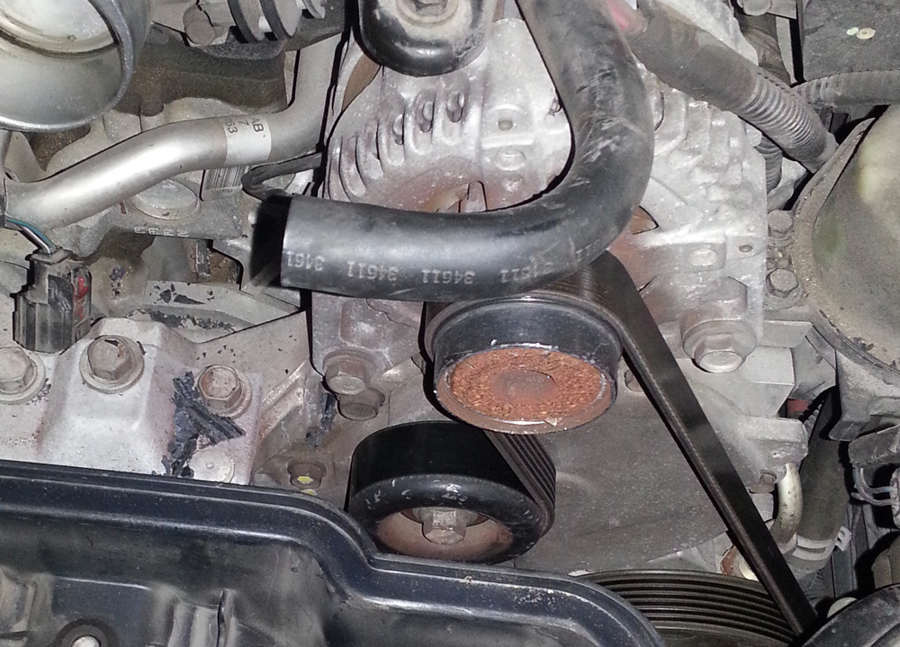

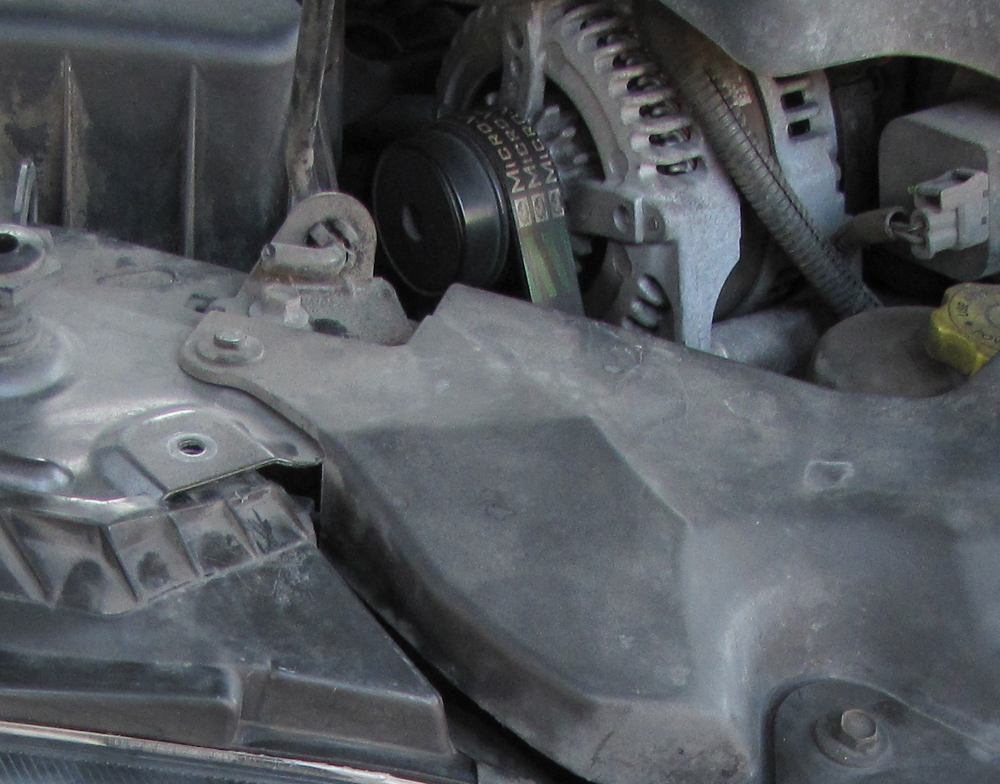

Took a while to figure out what the heck did it, but I found an older pictures of the car and saw that in the center of the alternator, there used to be a black cap of some sort that isn't there anymore. Best I can figure, that cap was spinning at somewhere in the 3-4K RPM range when it let go and wreaked havoc under the hood. Luckily, it was just teh airbox and insulation that was damaged and not the cooling lines or A/C stuff right around that area.

Here's what it should look like.
