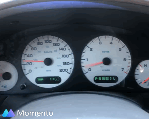

Wow!! Who would have Ever Guessed there would be ANY sort of connection with your Alternator causing your Transmission issues of any kind!!
I would just like to also Confirm that changing my Alternator was what fixed my jumpy Speedometer and hard Shifting issue. At times my Dashboard would become a Disco Night Club!! (See attached GIF)
Luckily I purchased a parts Van I could grab required parts from!! It was a perfectly working Van but the body was all beat up. So I took the Alternatir out of it and installed it into my Van and So Far So Good!!!!
I’d never would have thought that my alternator was causing those issues!!! Way to go Chrysler!!
