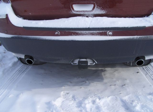

This is the factory hitch on my 2007 Touring.
