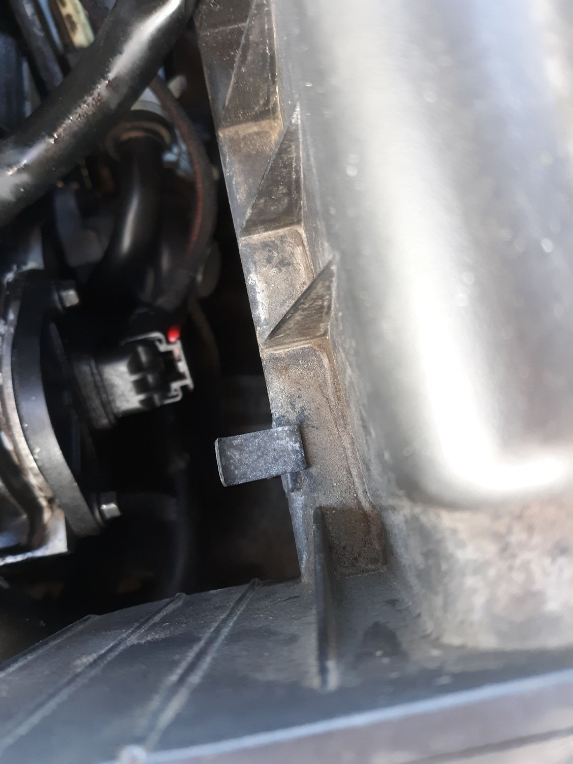

25. - Replace the housing cover by first attaching the hose and then putting it in place. Now Tighten the hose clamp. Then reclip all three housing clips. I found that using the screw driver as a lever helped tremendously in reclipping the drivers side clip near the hood.
A difficult clip
