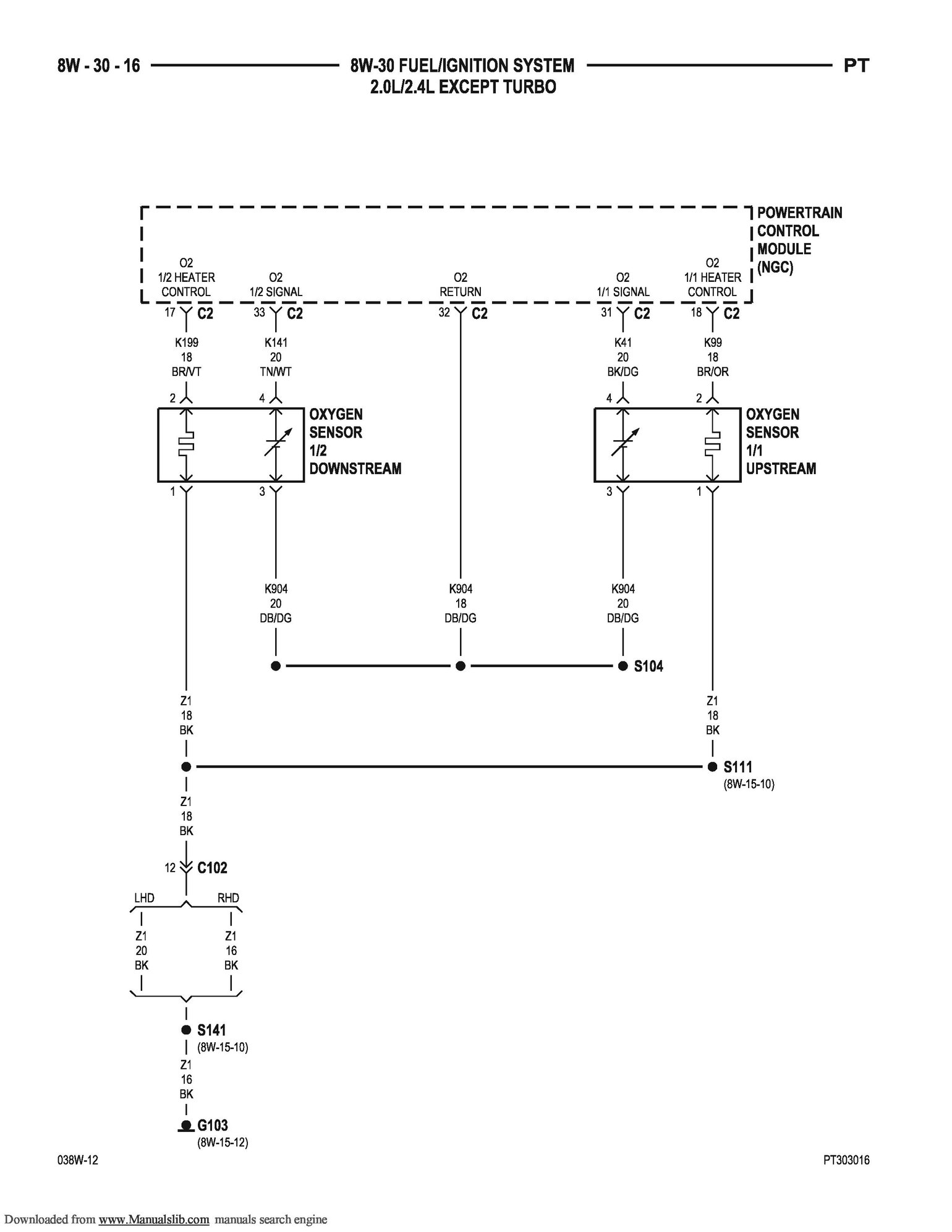

The car's not stupid. more likely it's been poorly maintained.
since both codes relate to the heater control circuit, first place I'd look is ground connection.
