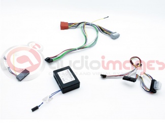

So, the one you've found online "Connects2 CTTCH002":
Is one I looked at also originally, it's listed as an audio mute cable but very little other detail on it at all so I'm a little unsure what and where that fits in.
My assumption is that it's talking on the CANBUS network on the car and controlling the amplifier via the audio cables as I suspected.
So when it arrives, would be very interested in better pictures of the connectors on it and also any wiring diagram it comes with.
I see what you mean on the version differences between 001 and 002, there is an interesting gap in the years it supports, mine is a 2005 so similar to yours fits inbetween the listed dates.

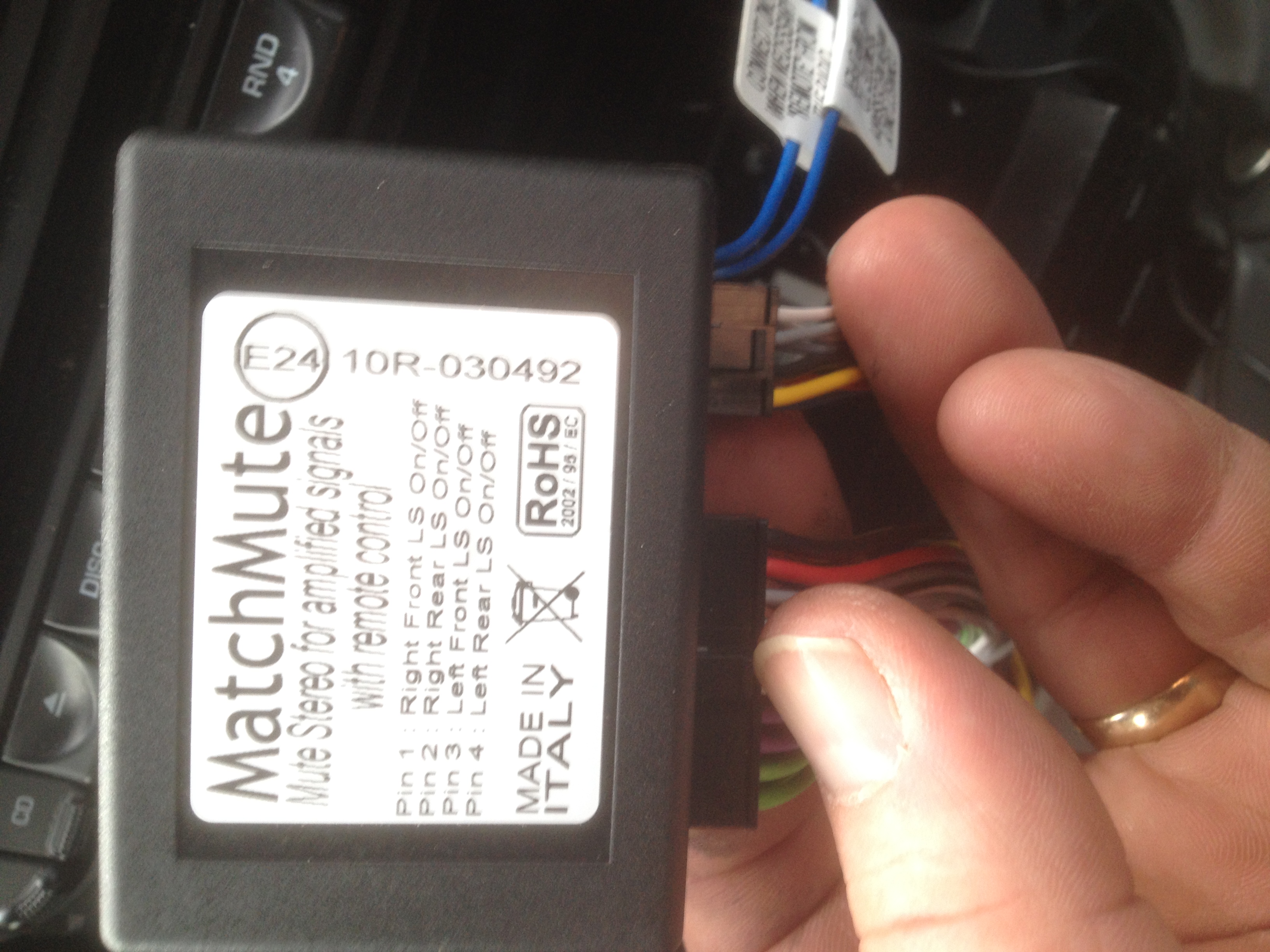

After a 4 week wait , my special part to adapt the parrot CK3100 for my 2.8 CRD GV ,arrived.
AND IT WORKS ................ Hoorah ! ! ! ( sod the expense .... cheaper than getting nicked ).
After a long delay and a possible change to the original part..............
A MatchMute ( made in Italy ) is the part that arrived , fitted and worked.
You do away with all of the Parrot leads ! ! ! and any sot (048 / 096 whatever ).
This has two connectors which fit directly to the Parrot blue box , and one connector to the car loom and one into the radio ............. that is it ! ! !
The new MatchMute has 4 din switches ( for different speakers ... on or off ), and an adjustable volume out screw.
So the only Parrot bits required are the blue box /screen and mic.
It cost me £90 , but money well spent I think.
Good luck

Have tried to upload photo.
Just says MatchMute ..............
Prefix with interface and a Spanish site has it.
As I say , I waited 4 weeks , so I suspect they could not source the original suggestion.
Attached Thumbnails 2.8 CRD which sot ???-img_0288.jpg   2.8 CRD which sot ???-img_0292.jpg

Dynamicsounds ( website for garage in Tooting SW17 )
Connects2 CTTAU001 - Audi A2 A3 A4 TT Handsfree Mute Interface Lead
The exact kit I received but for £56.00 ( Match mute ) DOH ! ! ! !

aha, yes the Audi cable was what I'd figured it was, going to try and get circuit diagrams for it and work out what it does, but initially I think all it does is switch out the audio to the Parrot source.
Will do some experimenting, as that leads me to believe the audio feed from yours is different to mine. But I probably need to spend another afternoon testing the various leads that feed in and out of the stereo and try to trace it down.
