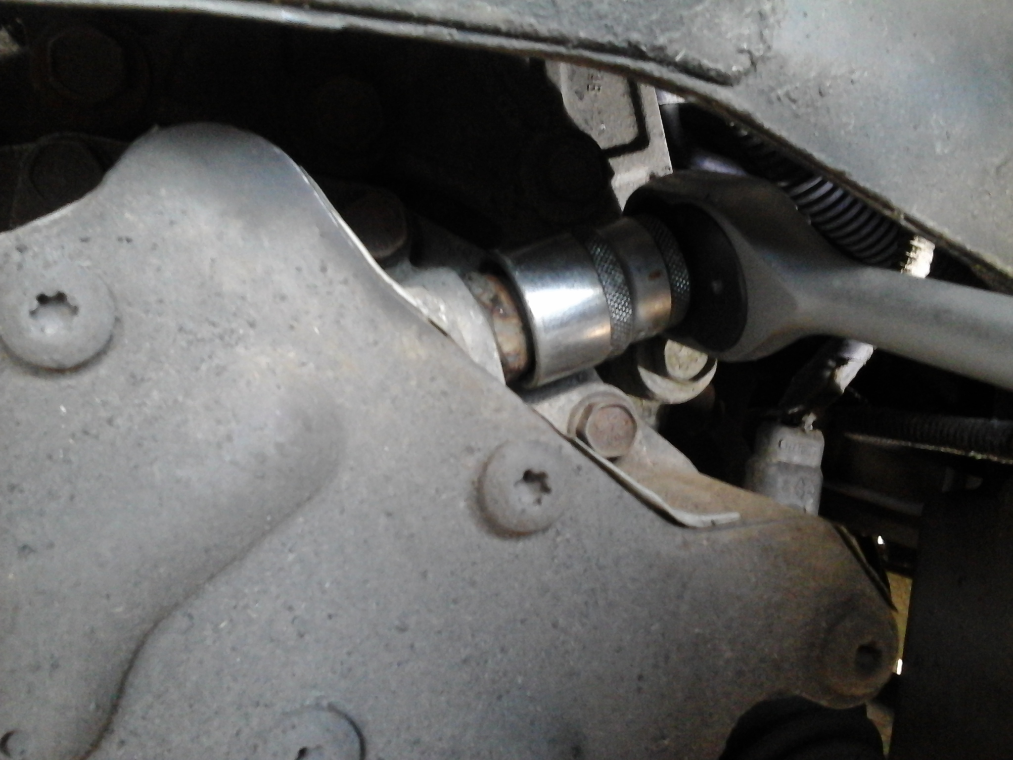

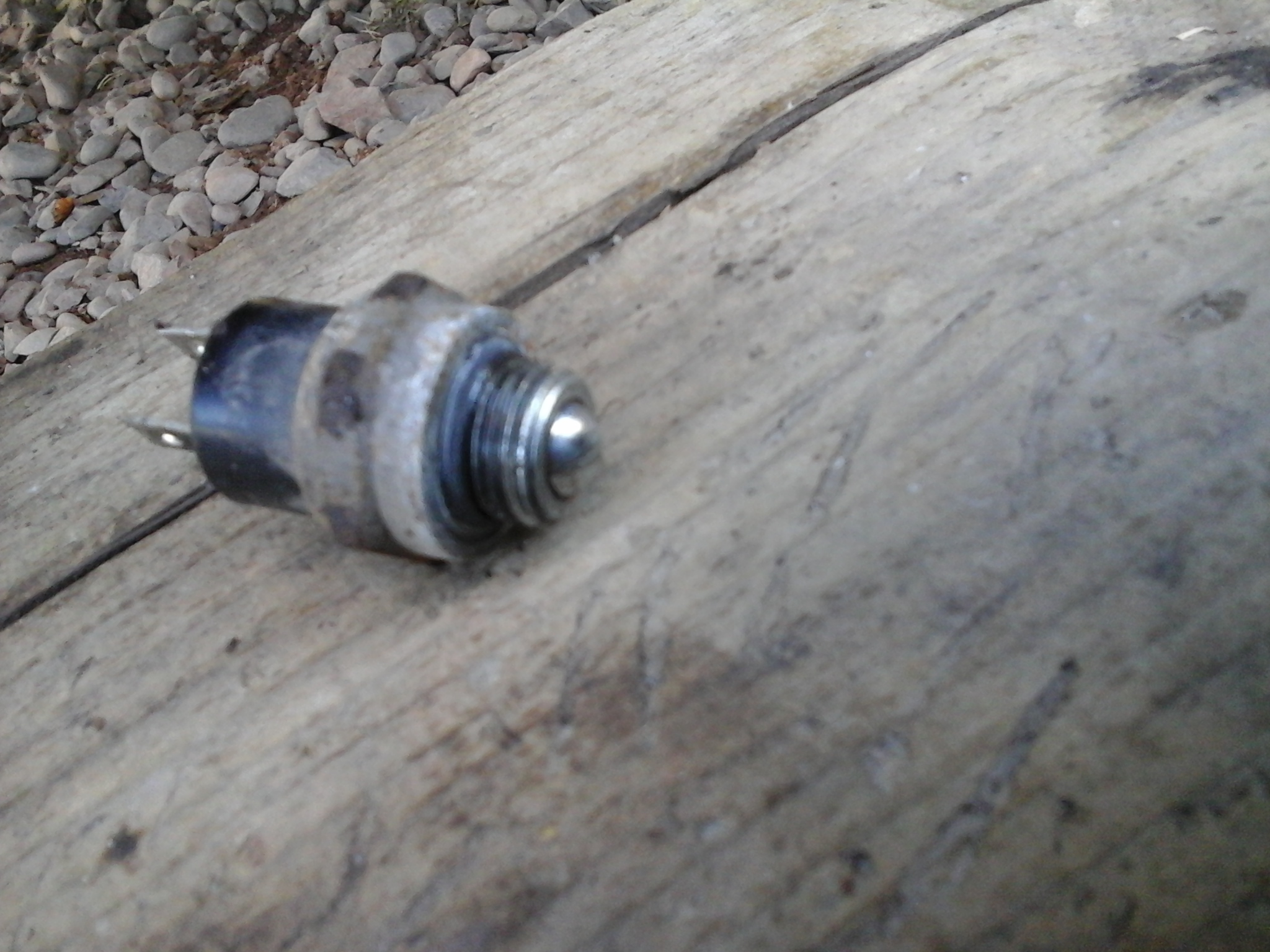

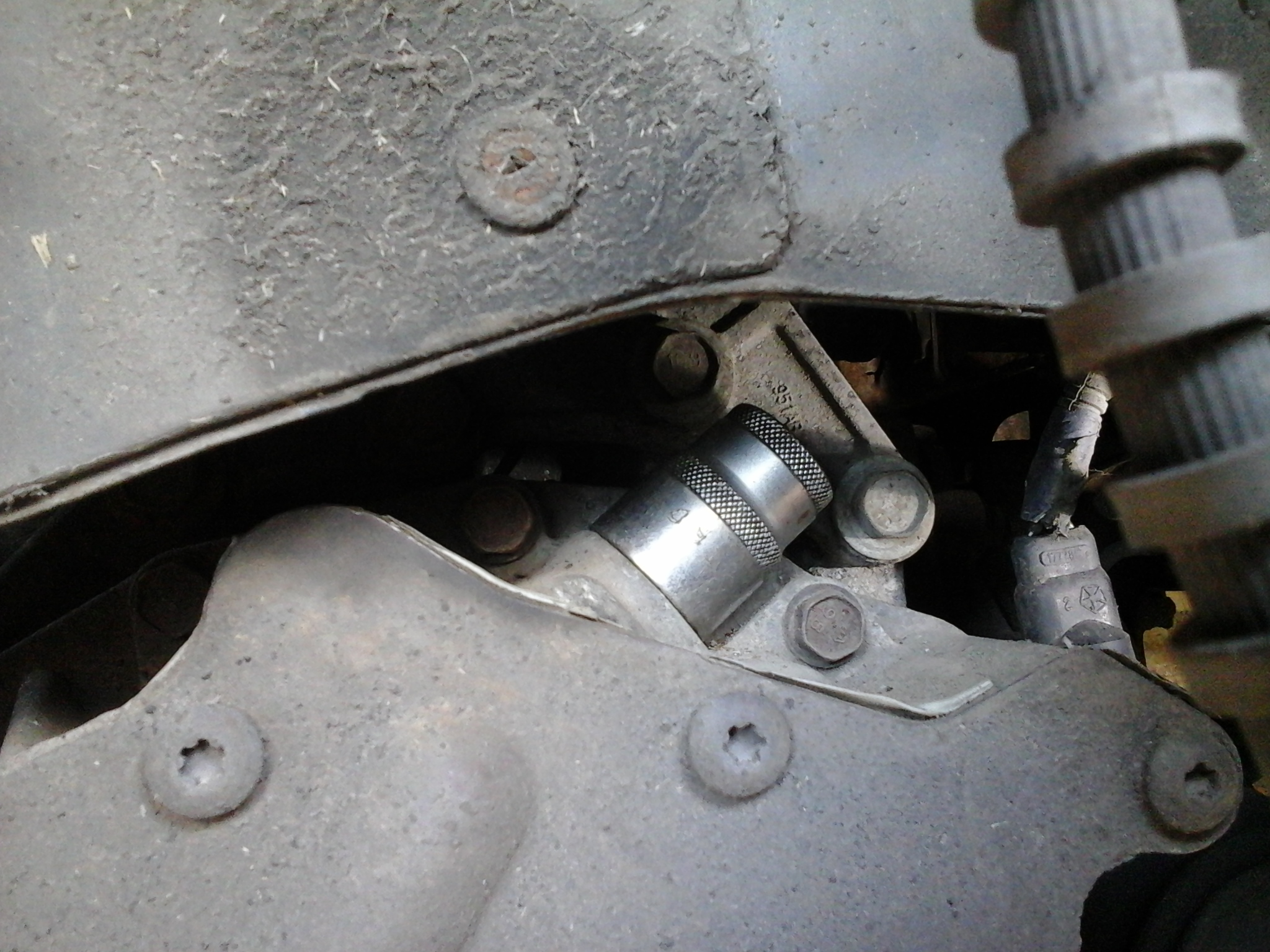

Checked mine to day and got one ordered after checking its operation. From picture of switch the ball on its end which goes into gearbox is obviously pressed inwards by gear selector inside box. This inward operation must operate switch to route power to rear lights.
Oh and by the way no box socket required to remove switch. Just fit ordinary 24mm socket onto switch then ratchet. Ratchet square doesn't fully lockon but catches enough as per picture

Thank you kindly sir. Pics make it easier to identify now. No wonder i couldnt see it i was looking for the wrong thing
Am i correct in saying its on front passenger side
Old Oct 13, 2015 | 02:12 PM
  #25
Yes front passenger side if you are RHD. Or left side if you are sitting in a RHD or LHD in the drivers seat looking out. Must find out if these LED reversing bulbs are stronger.
