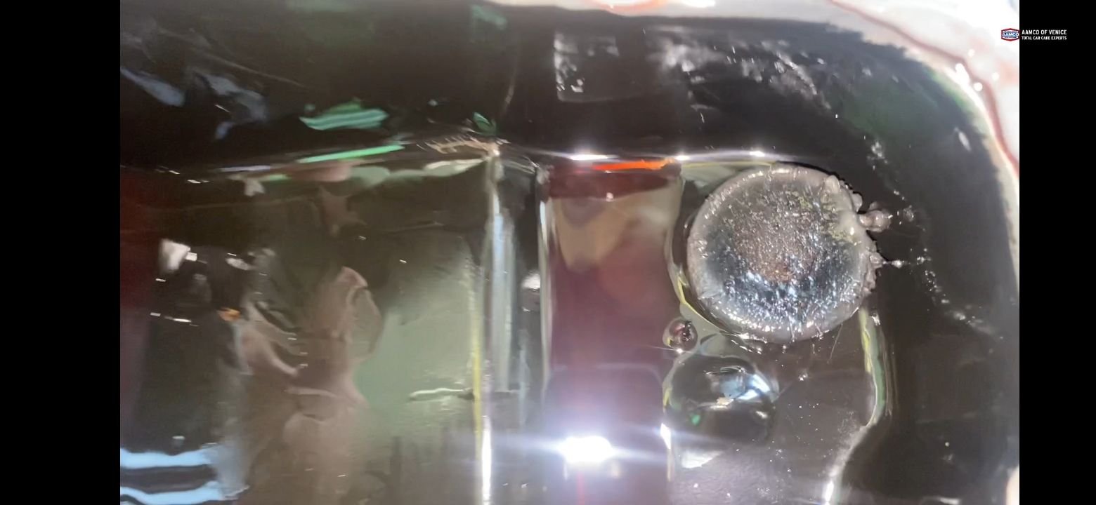

Aamco dropped the pan and found considerable shavings for being fully serviced only 3 months ago. They have suggested overhauling the trans.

That looks pretty normal to me provided they did infact replace the filter and such 3 months ago
Thanks for your input! I am glad and yet surprised to hear you say that. I have admittedly minimal skills with transmissions, but as a mechanic I see that amount of debris as a red flag. I'd love to be wrong in this case! if you consider this normal, what might you suspect is failing? I'll take any ideas or info you might be willing to share!
