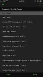

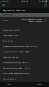

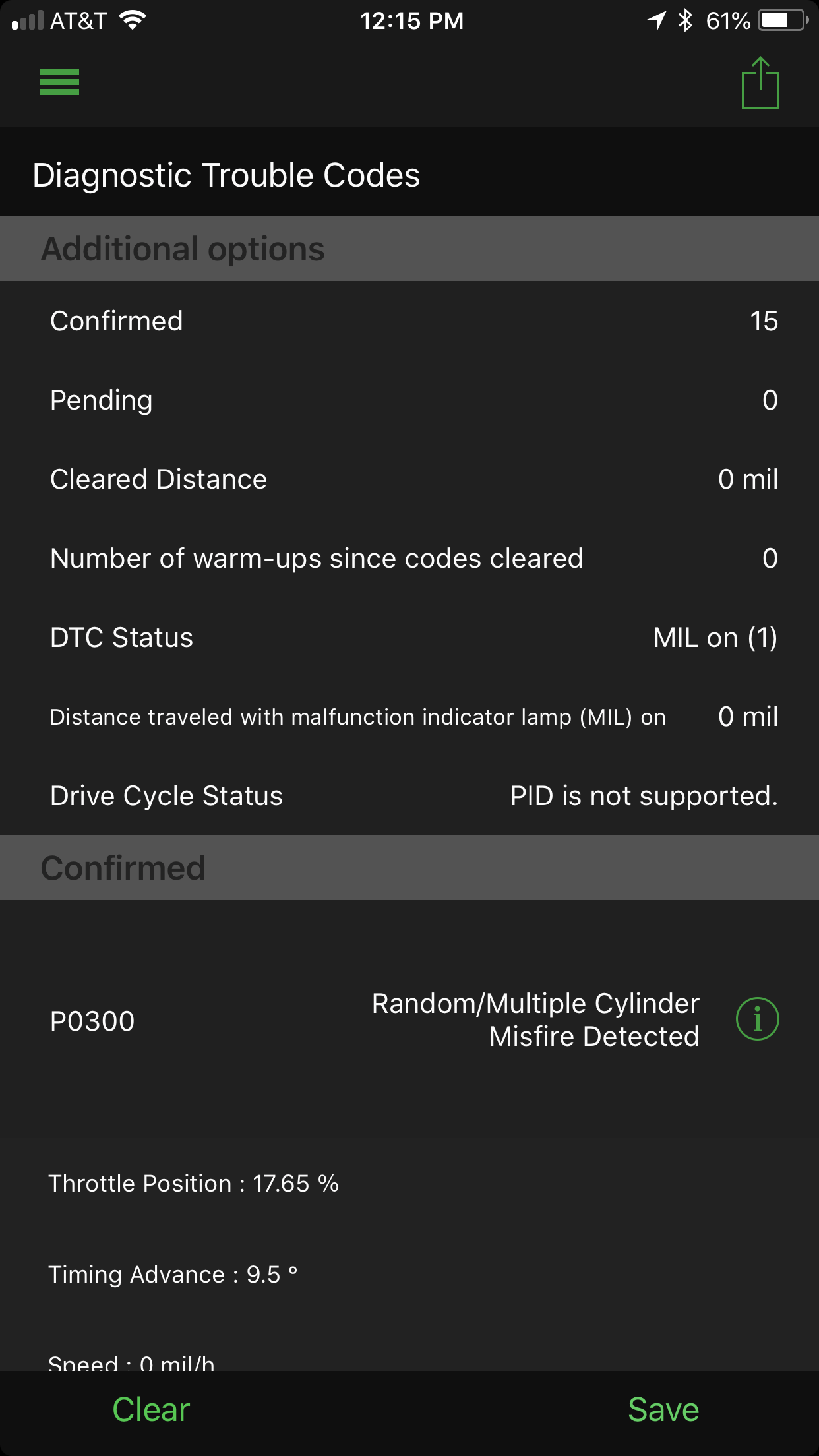

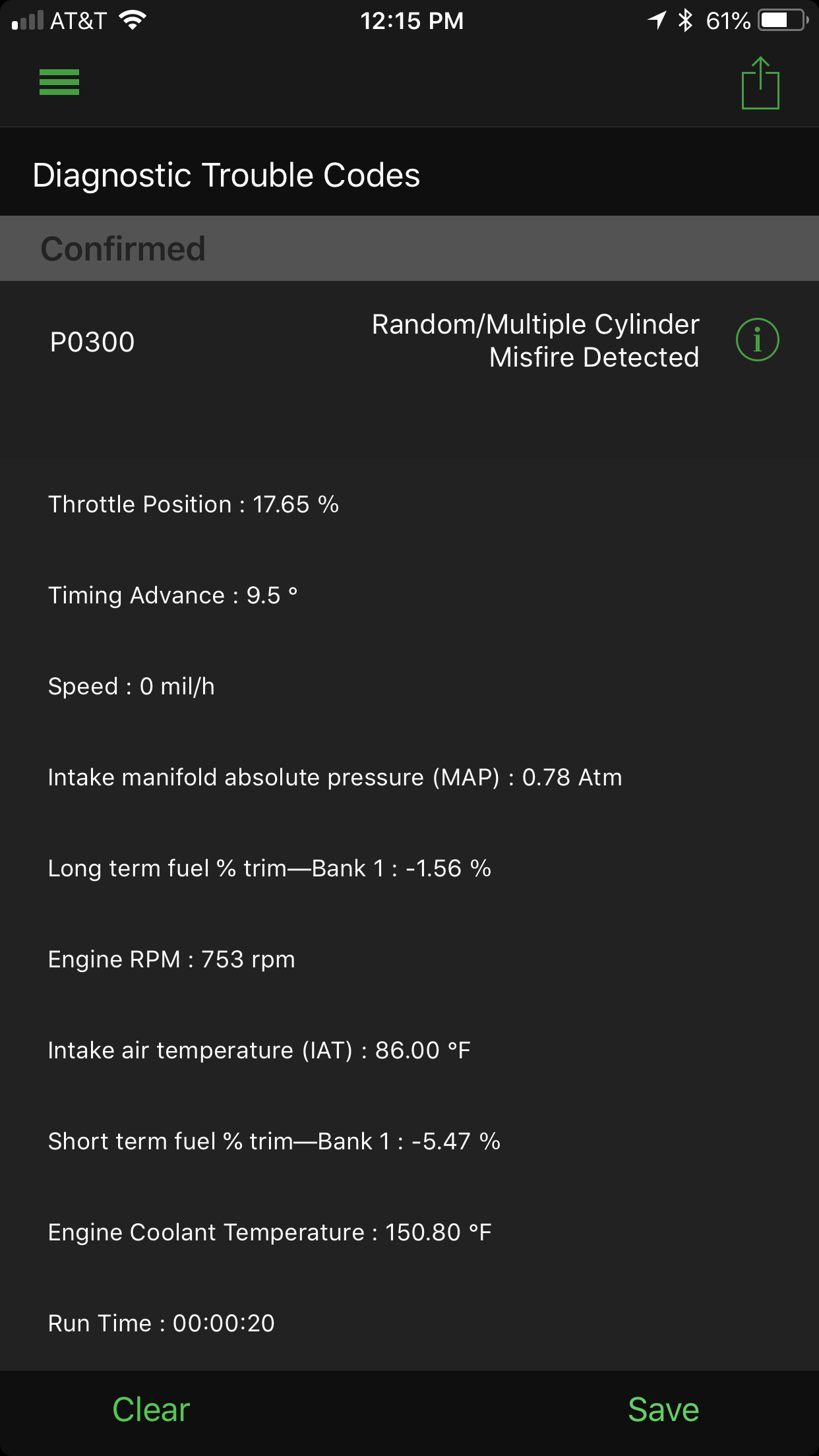

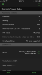

All - problems persist with my 2011 T&C. Since posting, the vehicle habitually throws P0300 and P000B codes. I have replaced the VVT solenoids, Camshaft phasers, numerous oil changes to flush any potential debris, and now can offer the following pics of the freeze frame with P0300:
I've read that P0300 can be thrown early by a confusion of the Open or Closed Loop system and tied to O2 sensors of Engine Coolant Sensor. Any tips from these readings would be great!!
