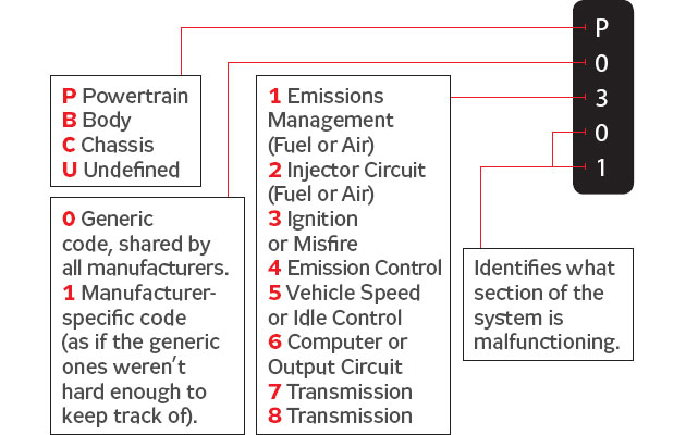

- "one of my clients has a garage" - Chrysler specific code reader required, £97 each and every time at a main stealer
In the UK you have more chance of marrying the Pope than getting useful codes, a quick 'key dance' on all voyagers will give you the P codes but getting useful codes is £97 each and every time at a main stealer. Every fitter I've known, and I know many dozens stares in disbelief when his three grand diagnostic setup gets about the same info as a 'key dance'
"any way of reading the code on the dash"- do the 'key dance'
-its a different car but the same sequence, it will only give you the P codes as stated
