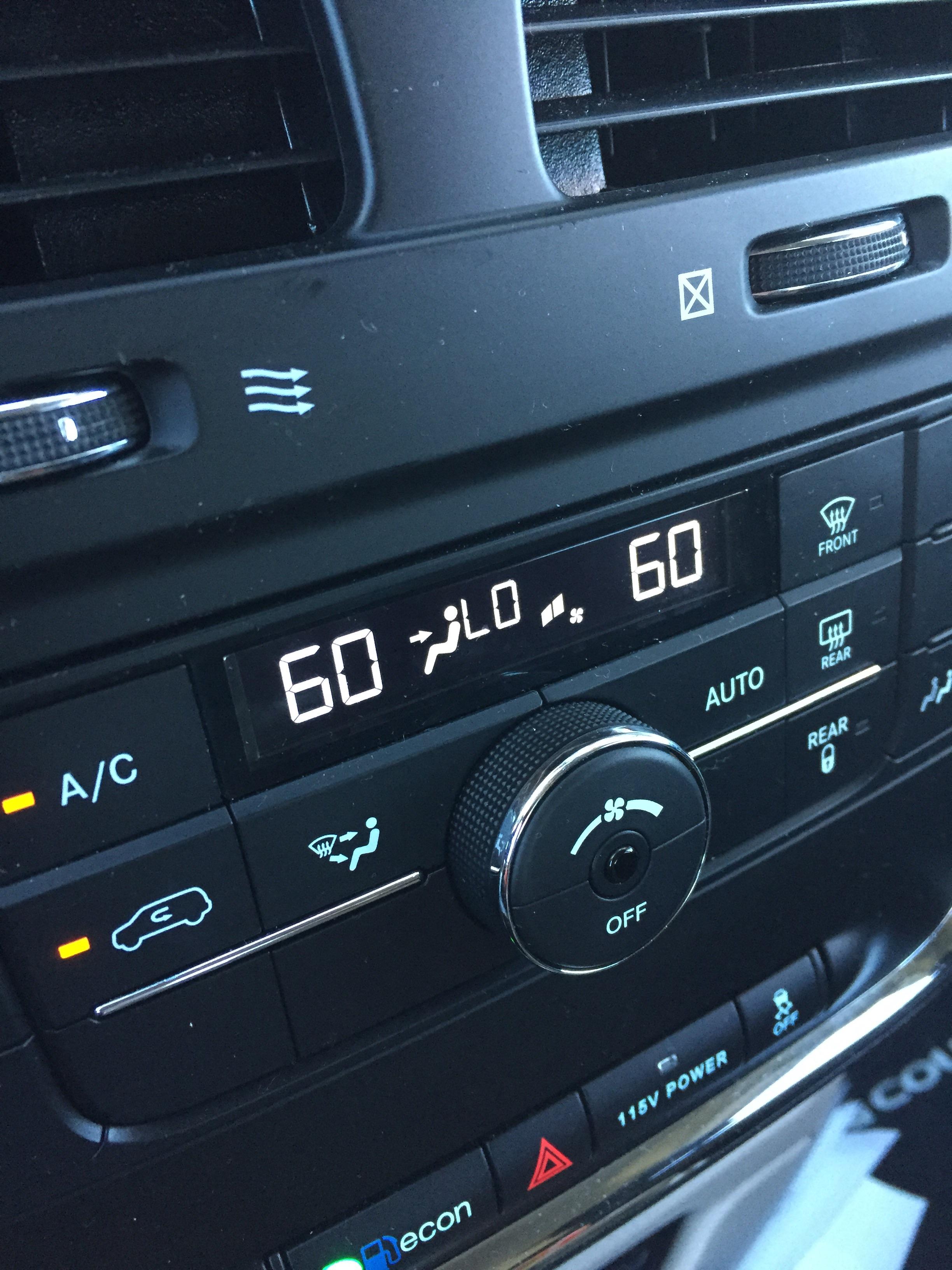

No matter what setting I use the display always says "lo". I've only had the van a few months and this is my first Chrysler. Is there a button I'm not pushing?
The lo in question is in the center one more down arrow from 60 it then says lo on the temp setting but the one in the middle is the confusing one lol

Ahh okay, the only comparison I've got with that then is my model has low and high which refers to the auto fan speed mode it's in, so I'd assume it has the same function. How you'd change that on yours, I'm not sure though I'm afraid.
