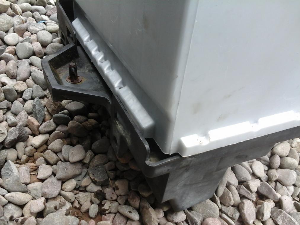

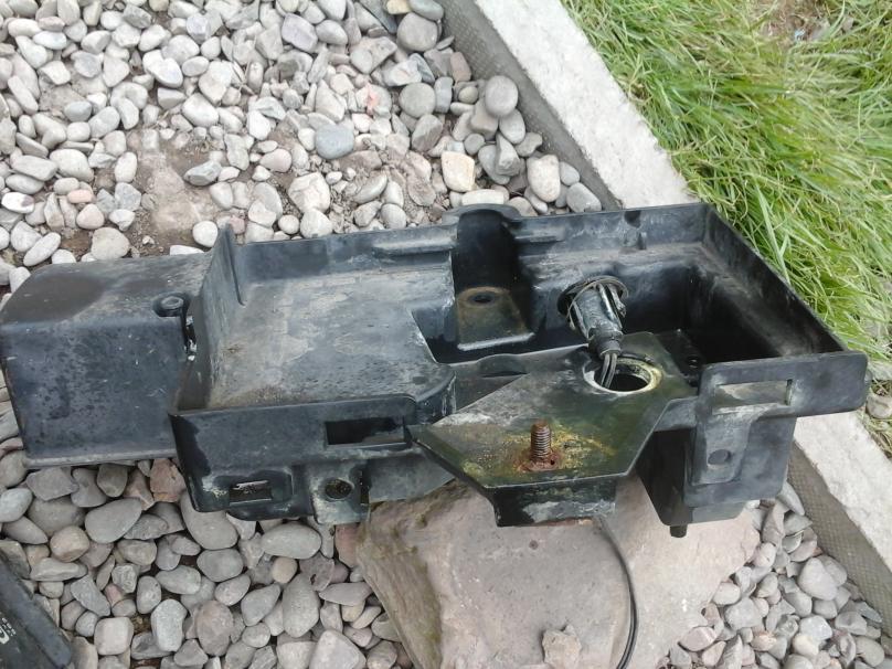

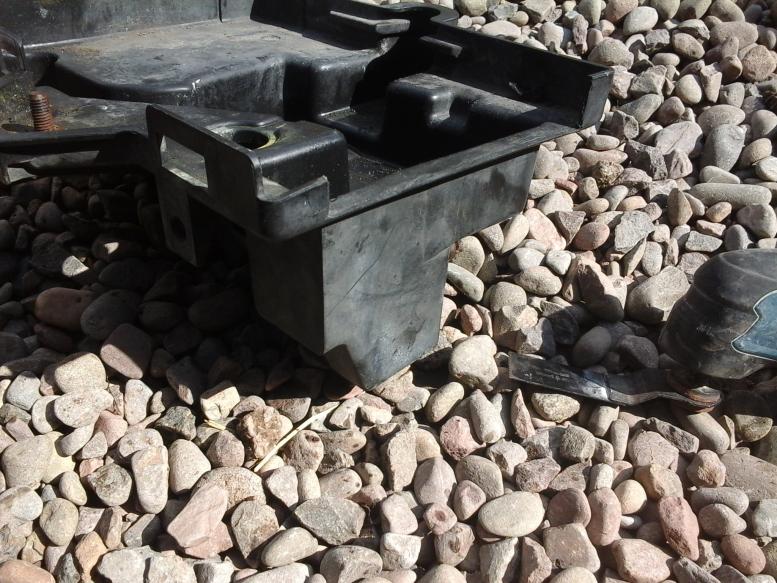

To make mine fit I just 'chonked' the battery tray and fitted a big Bosch, here's the pics of the bits I cut off. Others had success with other types this thread covers most of it. The recommended 640CCA is a joke for the UK winters on a 3 litre compression engine, it needs to be nearer 800CCA. For myself what the trade calls a Merc spec or £70 bog standard lead-acid 800CCA taxi battery is just what the doctor ordered unfortunately they wont fit in the little kiddie-tray [care here - the 1 1/2" thick loom does not like being bent and pulled and is just under that tray] on these cars.
Your best bet goggsie is to ask any members to help by saying exactly what replacement alternative battery they fitted without having to cut the engine bay or extend the cables. You could also take Richies advice and put in an RTC4.2 AGM - they're a bit salty at £140 delivered, and only have a 24 month warranty which works out at £5.53 a month as the price paid for peace of mind.
Best of luck.

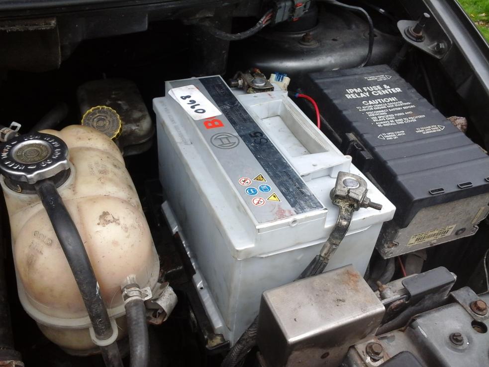

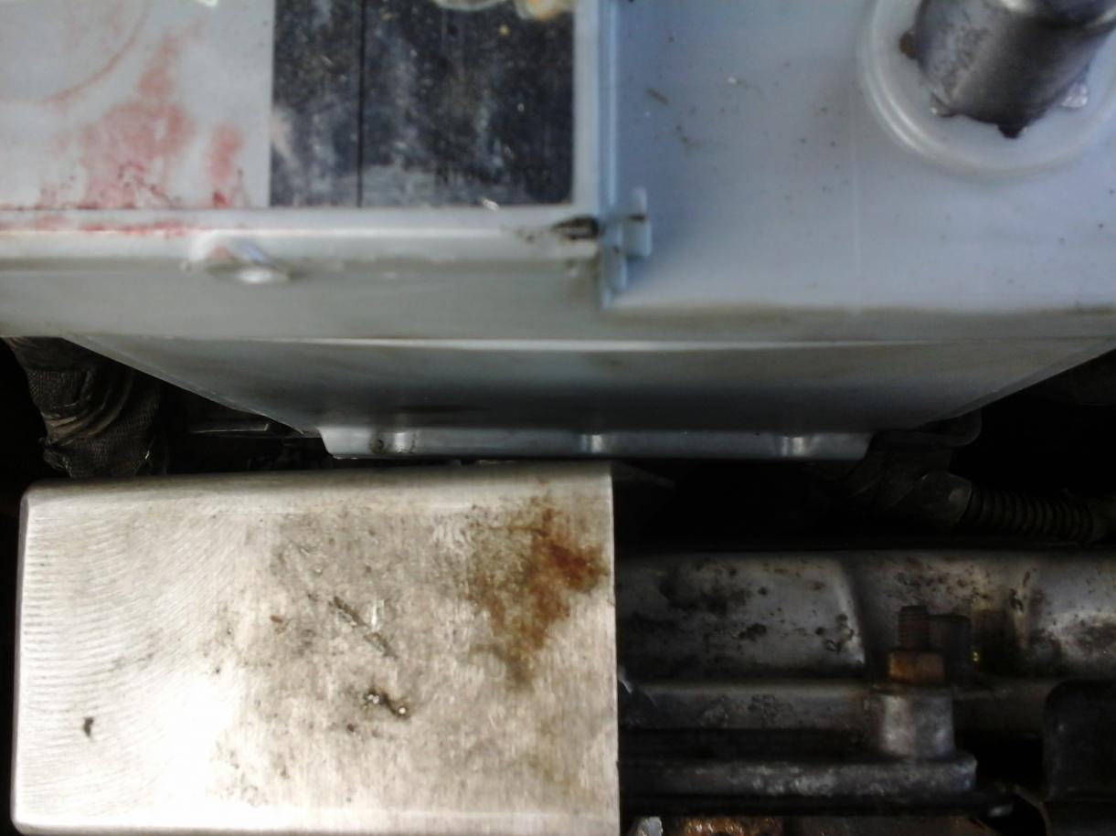

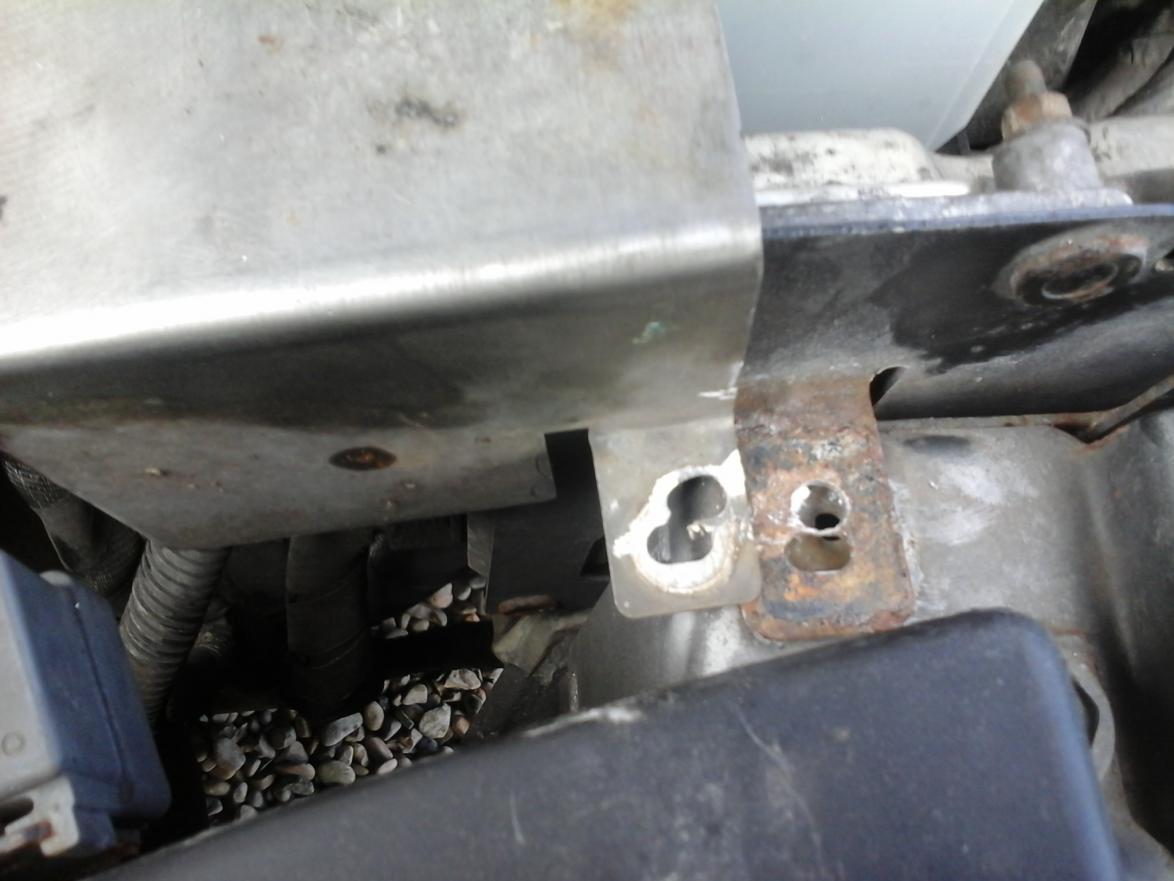

Well I got it in with minor adjustment to Battery tray and opening up mount holes in the front computer and its protective cover.
Battery is a Bosch S5 Type 096 with height and width same as old battery but length is 4mm longer than battery tray.
A leading car parts supplier is discounting these at mo so I was tempted and as my Motorhome was in need of a battery it gets old one.
See pictures as to old and new battery and new in place. Other pictures are available but usually have problem in putting them on.

Notice the removable temperature sensor that has been mentioned on her that is positioned on tray base.
