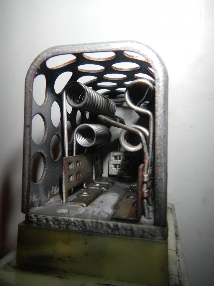

I had the following problem: "If your heater blower only blows on high speed, most likely the blower resistor is bad"
So I ordered a new one on Ebay (like €25,- ) and Tataaa problem gone.
But..
I looked at the old, "broken" one and I could not find anything wrong with it, even worse, I could not see what the hell could go bad on these?
I mean, its massive coils of metal look clean and good and only need to "resist". No bad corrosion whatsoever.
The only thing I see which eventually could be broken but should be easily replaced is the small closed resistor in the middle...
I will try to get a resistor like the one in the middle and replace it and test the system again.. that way all can save a few bucks because it seems to happen to all Chryslers sooner or later.
Attached Thumbnails blower resistor bad, but how?-klein-002.jpg   blower resistor bad, but how?-klein-008.jpg

I found on "the other forum" that it most likely is the "Thermistor" the electronic part in the unit in the middle which I thought was a resistor.. I just have to find where I can buy that thingy.

Oh right I thought you had bought another exact same replacement instead of solid state one. The old design was rubbish from the get go - they rust up, hence the reason they are in the cabin, the rust is the resistance, to overcome the resistance it pulls more current, pulling more current blows the thermal fuse. I've no idea what °C it blows at but it will be around 200°C + - see what it says on the one you took out.

Strange thing is there is as good as no rust on the coils/resistors..
In the meantime I found the thermal fuse I would need SDF DF141S Cantherm | 317-1134-ND | DigiKey
But All I read about the old resistor unit is (like you say) a rubbish design so I won't bother repairing it with a new thermistor.

I would have thought 141 v was a bit low but I've never actually opened one up. It can look pristine, as earlier [#4] its often times a lazy or part seized motor that has the same affect on the fuse, give the motor a spin and see if its smooth / lumpy or loose / tight.
