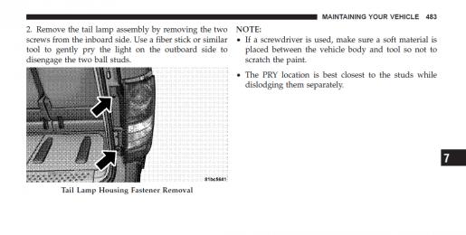

There are no black plastic plugs on this unit. It looks like it is glued to a wraparound piece of plastic that is secured with two torx screws. I loosened them but the piece won't come off. I don't want to break it by forcing it. Is this the way to remove the cover?

This is in the 2010 manual, same as 2002 except its 2 screws in stead of 2 plastic plugs

Thanks. It was easy if you know how. It's changed and working.
