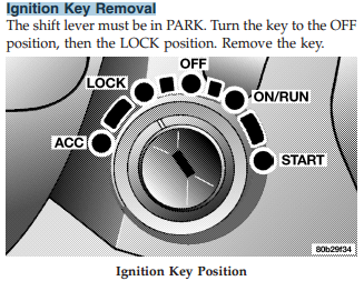

HiYa Vmaxxer,
why the hell isn't this communicated by the Chrysler dealers and garages
It's in the handbook, see below :
Even if you have no handbook, if you look at the plastic surrounding the key insert you will see a clearly defined elevated [in relief] plastic line 'key removal point', so defined in fact that a blind man could feel it without sight. Welcome to the GV owners forum, they do suffer badly with 'parasitic drain' that's something you have to look forward to next winter. There's plenty of info in the forum - if you are stuck - just ask my friend.
