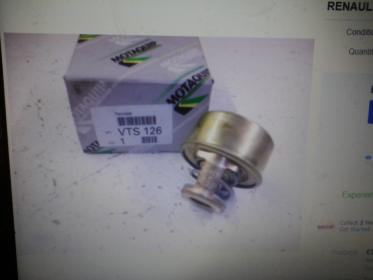

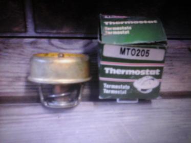

Had a view on You Tube yesterday and there is a video relating to the Voyager CRD alternative thermostat but its in a foreign language. Right enough their pointing to the green hose but instead of the Renault 5 thermostat like I've said they mention the Renault 9 thermostat. I have came across the picture of a hose fitted stat while browsing but at a loss at mo..
Old Dec 20, 2014 | 02:34 PM
Looks like Renault 5 and 9 Stats are about the same. The 9 refers to Renault Petrol 1400cc 1981 on..
Renault 9 on left of box.
But whether 5 or 9 the stat most likely refers to the engine. Anyone got a manual on these cars so we can pinpoint if this stat is fitted in the hose.
Attached Thumbnails Cold Heaters-renault-5-stat.jpg   Cold Heaters-renault-9-stat.jpg
Old Dec 20, 2014 | 02:40 PM
Vmaxxer's Avatar
Joined: May 2014
Posts: 510
From: The Netherlands
Does it matter from which car the stat comes?
As long as its like ~ 43MM diameter to fit in the tube and opens at around 85-90 degrees Celsius it works, doesn't it?
