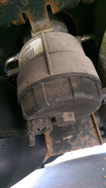

A pal of mine who used to work at a garage chain suggested fuel filter, and since it's not something I've changed since I bought the car, sounds a reasonable place to start, the more I replace the happier I am, peace of mind that I've done the job and know it's done (right?!)
Just to make a note, mine is 2.8CRD 2005, and it does NOT have the front screw on filter, it's got the rear filter just in front of the rear axle.
I'm guessing to change the filter, just disconnect the connector (water in fuel sensor) and use the large plastic nut in the middle of the base to unscrew it, drop it out and fit the replacement filter in?
Worth a go for 11 quid I reckon since it's never been done to my knowledge.

Yep, that looks much the same setup to the 2002 I had.
Just as you say for fitting.
When I'd done mines, I put it back on as tight as I dared (only had a shifter for the plastic nut at that time and didn't want to cause too much damage to it), but it ended up not being tight enough (drew air cutting out car sometimes) and had to remove it again to make sure I hadn't left the old o ring in, and retighten.

I'm 05 LWB ltd and you are the same on a XS package. Yet these cars can be so schizophrenic on builds [WMI designation] in yours and everyone else's VIN number. I'm spin on in the engine bay with a hand operated in line hand pump in the LP side, the LP on my car is a function of the HP pump in the engine bay. Yours appears to be [pull not spin] bolt on [24mm] near the fuel tank rear where the LP function is provided by an electric 'tick tick' lift pump. A squeeze Lucas type hand primer is a cheap purchase and a reassuring check for LP to HP pressure. Changing yours should be easy, just make sure you oil the O ring and all fittings are tight and check for splits in the supply line & weeping joints allowing air to be vacuum[ed] in displacing fuel.
Yes air pockets in the LP fuel supply are a frequent symptom of hot & cold starting, proving the LP with a hand pump is an easy test, proving the LP without a hand pump will be listening for the tell tale electric tick tick NOT stopping.
