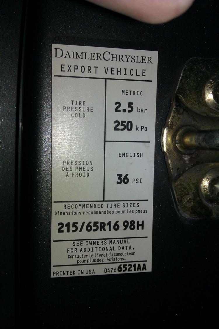

Hi Jake, well the tyre size you have quoted are the same for my 2003 CRD LTD Grande Voyager. The important part in the size is the load index, which here its 98H. Never put a lower number tyre on as it would infringe you insurance if you had a bump. For reference Commercial Van's because they carry higher loads have a higher number, 102H, 109H say.
As too quality, its what you can afford, distributor tyre dealers will sell you any make, many come from China take note, but the tyres have to be up to the job.
See my Tyre plate.
Goggs.

Hi, the picture I enclosed is the label that is stuck on the post inside the drives door.
Goggs.
