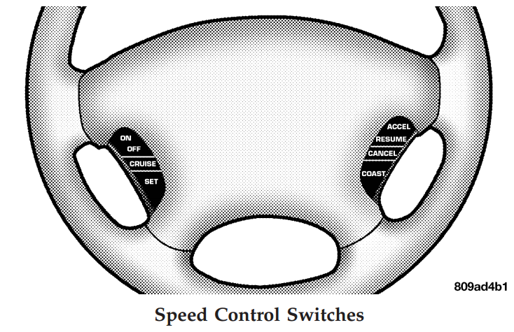

- no - they are not lit
- cruise only comes on at 30 mph
- the top accelerate / resume button speeds cruise up at any speed above 30 mph
- the bottom coast button slows cruise down
- the coast button disengages [while pressed] and re-engages [when you take your finger off] cruise
- tapping the coast button will decrease your speed by 1 mph for each tap
- tapping the coast button three times will decrease speed by 3 mph" !
- tapping the acccel / resume button once will result in a 2 mph speed increase
- tapping the acccel / resume button three times will increase speed by 6 mph
- the brake will also disengage cruise, pressing the acccel / resume button will re-engage cruise at the original setting
- If you want a different cruise speed press the set button again
