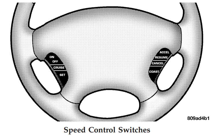

Old Apr 4, 2020 | 01:21 PM
Never on my 04-08 UK
- no - they are not lit
- cruise only comes on at 30 mph
- the top accelerate / resume button speeds cruise up at any speed above 30 mph
- the bottom coast button slows cruise down
- the coast button disengages [while pressed] and re-engages [when you take your finger off] cruise
- tapping the coast button will decrease your speed by 1 mph for each tap
- tapping the coast button three times will decrease speed by 3 mph" !
- tapping the acccel / resume button once will result in a 2 mph speed increase
- tapping the acccel / resume button three times will increase speed by 6 mph
- the brake will also disengage cruise, pressing the acccel / resume button will re-engage cruise at the original setting
- If you want a different cruise speed press the set button again
I use cruise 99% of all out of town centres all of the time, it seems to average about 500+ RPM [-] for any speed setting. I believe that no human can out-think a puter, we just cant make 100 throttle calculations per second. The only issue I have is that heavy traffic and fluctuating speeds and icy conditions can make it a very dangerous and unforgiving device.
